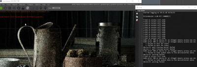

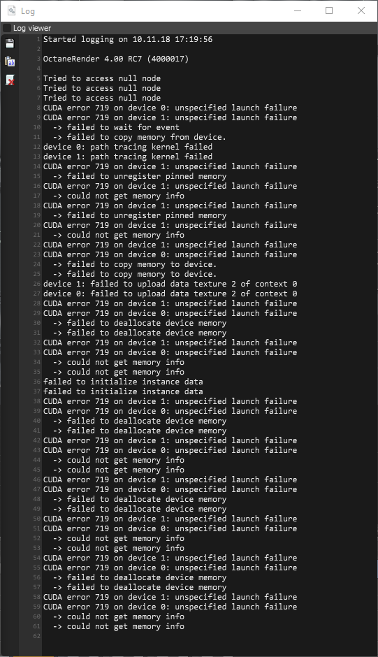

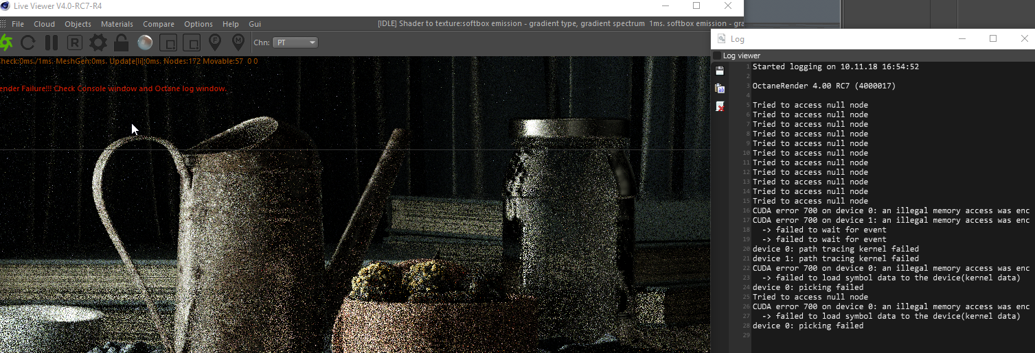

Hi, i get this all the time. I guess as described i have to play with drivers? I noticed it happens only when i have denoiser enabled.
edit: it happens when i copy paste objects while in live viewer mode. IT happens also if i close and restart lv.
edit2: oh it happens also without denoiser

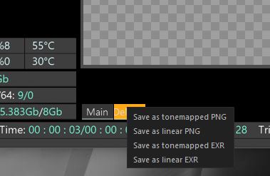

From the LV are you saving via the menu? Then yes, it seems that only saves the Main pass.
What you do is right click on the Demain tab at the bottom and it will give you the option to save. This will save the appropriate type with alpha. See image:
Save options.JPG (21.21 KiB) Viewed 4604 times

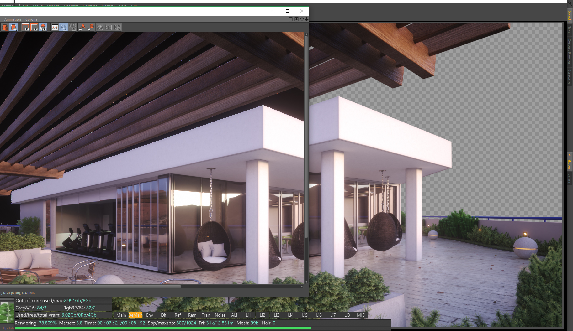

Hi, BCres
Thats what I've been doing... it works. However the alpha won't be saved, I get a black background.
Maybe I'm missing some step...
EDIT: even if I export each image to the picture viewer I get the same result, see attach.
What am I doing wrong?

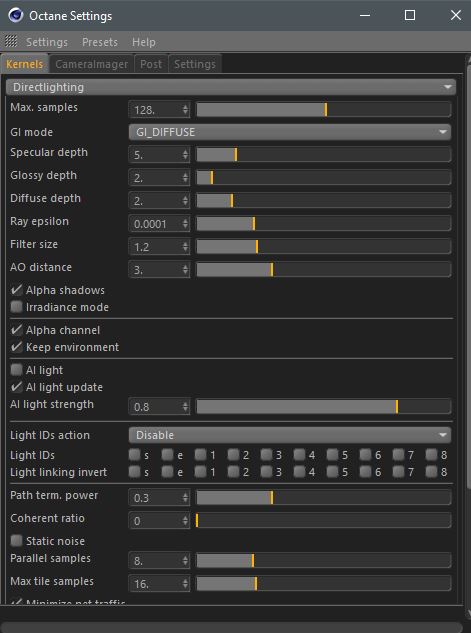

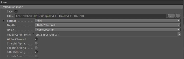

Kalua,

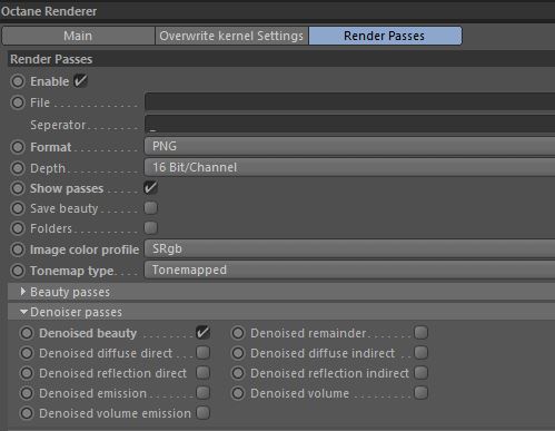

I'm sorry I can't figure out why yours isn't working. I've attached four pics to show you the only settings I have turned on that might affect it. (My max samples are set low so I could tell I was saving the Denoise w alpha and not the Main, which I was.)
If it's not one of these, I'm out of ideas.
use Denoise beauty.JPG (30.17 KiB) Viewed 4320 times
