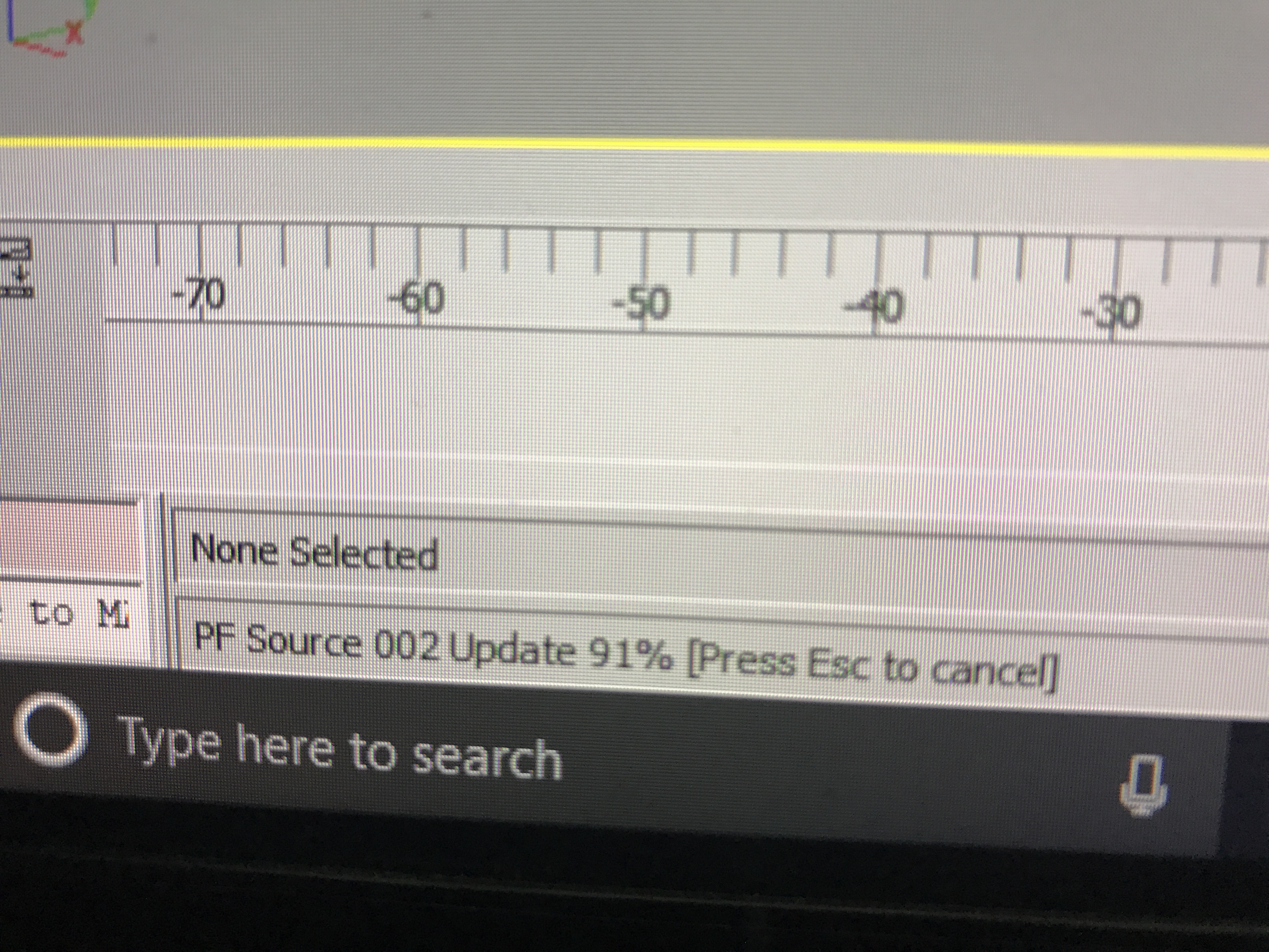

HI Paride
I emailed you 3ds max file with phoenix fd and pflow in one scene
Could you please send it to developers so they can try to render sequence frame 500 and up.
Can they also try to render two version with " Disable Pflow mesh instances" CHECKED AND UNCHECKED
Our render times are crazy slow in the actual scene 7-10 min evaluation time for each frame not including rendering with both disable pflow instances on and off
Hopefully they can fix it. We are not sure how to render with this speed. Thank you!
Also the slowest times start happening after frame 1. with PF Source Updates
OctaneRender® for 3ds max® v3.06.4 - 4.39 [OBSOLETE]
UPDATE: It looks like slow pflow problems were solved using Disk Cache in Pflow.
We had to precache all firework particles. I guess when octane is ready to render next frame "processing geometry" it interferes with pflow calculation of the next frame particles. Scene loading went from 13 min to 19 seconds.
