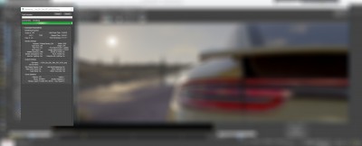

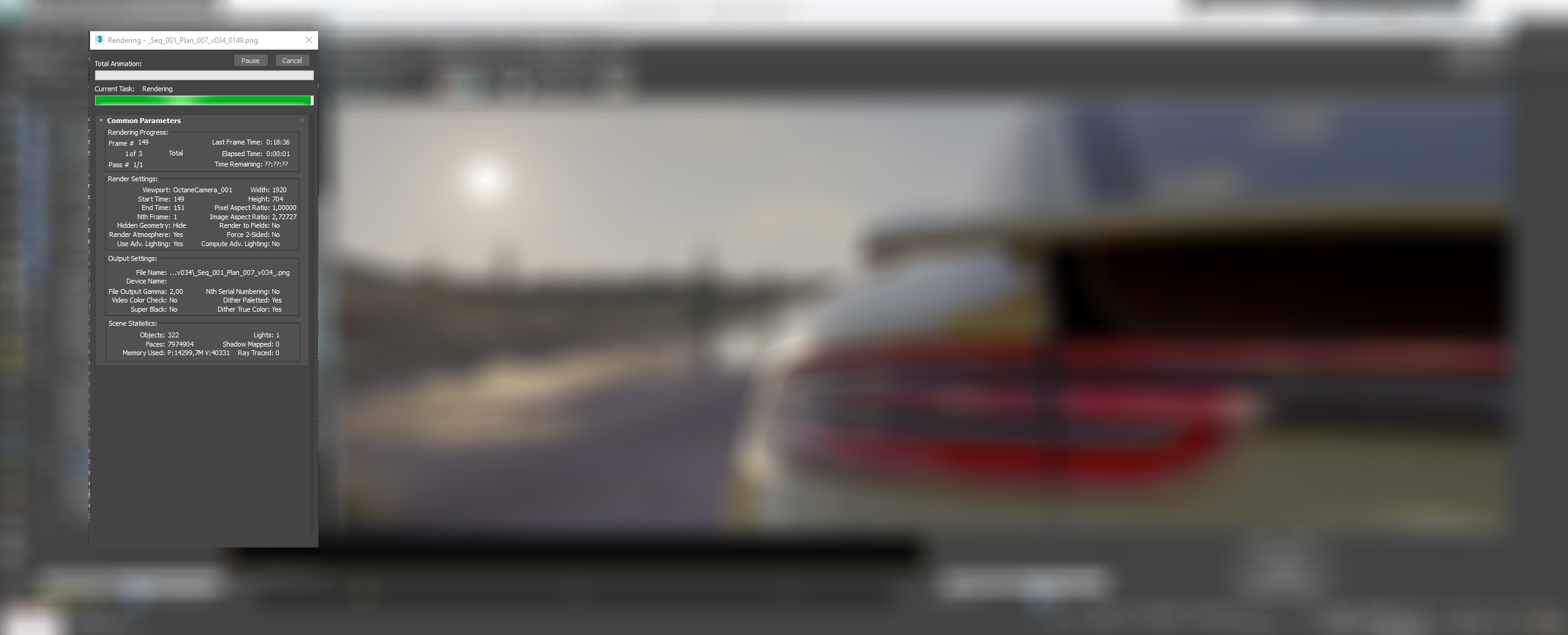

I have a little trouble with 3.06 rendering. sometimes, my render is stopping a little bit before ending. I don't understand why. Nothing to do to finish the render, but no problem to press cancel.
I thought it was because i activated "limit visibility to camera" into Itoo Forest pack, but, it is not.
I thought it was because network saving images, but is not.
In my scene i have baked animated car, large terrain and some itoo forest pack scatters.
is this a knowed problems about items used into my scene ?
I precise i have a lot of shots is working fine and i don't know why sometimes a frame is blocking all my render.
I precise another thing i use network rendering of Octane with multiple computers with 4 Gtx 1080 each.
Can you help me please ? Thanks.

Hi finkaboutit,
It's hard to say with only this screenshot; I think your issue depends on a Ram limit on your pc.
You could make this test:
Eliminates all Elements render
set max. Tile sample > 1
Waiting to hear from you
Regards
Paride

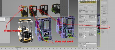

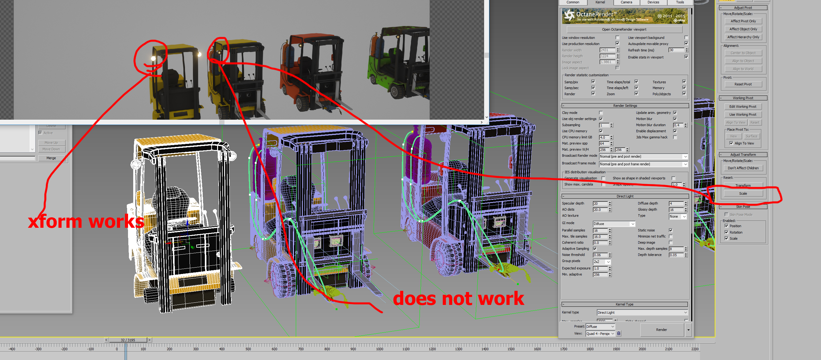

not sure if it is a bug if a mesh scaled using regular scale and then resetting scale transform does not work with octane. octane still sees it as old original scale size. Xform reset must be used. Can you guys have reset scale working under pivot tab
