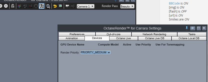

Hi Simon,
I just installed this latest version, and it is not rendering.
I am only seeing an empty grey render viewport. Have tested several files, including a new file. Have also restarted.
dual zeon
win 7
Nvidia cards:
GTX 970, 980, and 2 Titan X
nvidia graphics driver: 376.33
Thanks for your help,
Rick

Is the standalone working?
Are the devices enabled/recognized?

Using the benchmark.orbx file, the latest StandAlone 3.08, is not working.
StandAlone 3.03.04 was able to render the benchmark file.
The Carrara plugin does not show any devices, nor the ability to enable any devices.

Hi Simon,
Update:
The good news: I got the new version to work by downloading and installing the latest Nvidia driver. Both StandAlone and Plugin now work.
