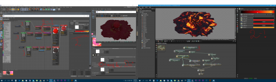

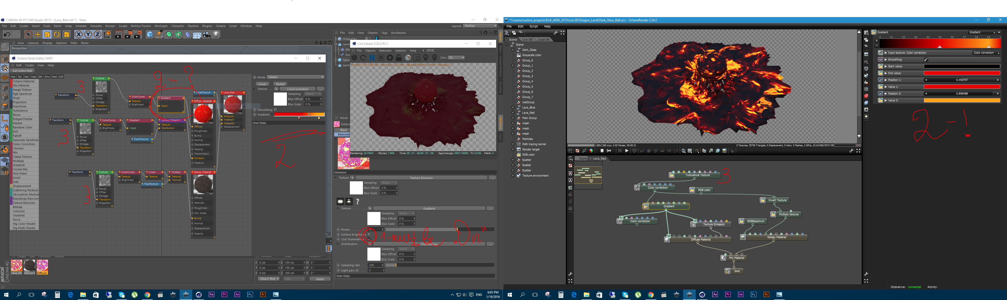

uncia wrote:Hi, Aoktar. Is Material import from Standalone broken ?
Just made lava material in Standalone and in Cinema it's totally wrong .
did you detected which parts are different?
uncia
Posts: 147
Joined: Thu Jun 03, 2010 9:02 pm
Location: Ukraine, Kyiv
Yeap :)
1. Surface Brightness - Plugin is ignoring this setting
2. Gradient node
3. Many duplicates in Cinema . why ?
Posts: 16068
Location: Türkiye
uncia wrote:Yeap :)
2. Gradient node
I think you mean external nodes. Nothing is duplicated, we just don't have internal nodes as in SA.
uncia
Posts: 147
4.-In colorCorrection node "Contrast" is ignored by Plugin
5.-In Turbulence node "Gamma" is ignored by Plugin
6.-In Gradient node "Smoothing" is ignored by Plugin
Posts: 16068
Location: Türkiye
uncia wrote:4.-In colorCorrection node "Contrast" is ignored by Plugin
Thanks. I'm fixing these.

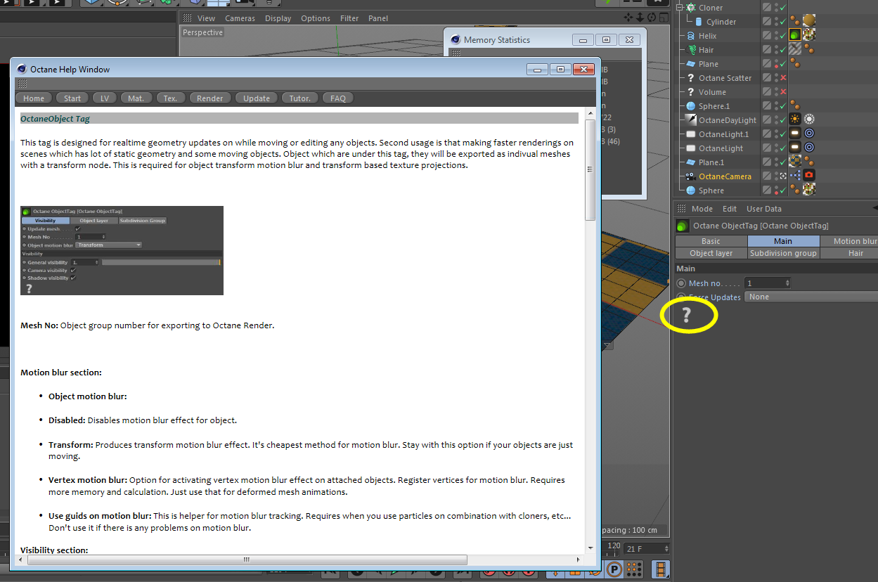

is there any documentation of the current object tag?
i can only find this: https://docs.otoy.com/#36OctaneObject%20Tag
but thats old.
for example what does the checkbox Object ID do?
Posts: 16068
Location: Türkiye
fuchsundvogel wrote:is there any documentation of the current object tag?
but thats old.
Couldn't you see this ? button? There are some help buttons on tags, etc... for calling a help window. Also having a pdf in manual directory.

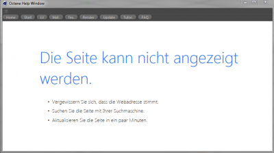

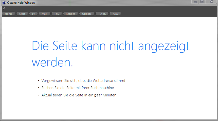

fuchsundvogel
Posts: 102
Joined: Tue Jan 06, 2015 3:21 pm
but thats old.
i can see the button, but:
viewtopic.php?f=85&t=52078&p=260891&hil ... ng#p260891
Posts: 16068
Location: Türkiye
fuchsundvogel wrote: i can see the button, but:
it's available for recent versions until latest release. You should download manual.zip and extract to c4doctane directory.
