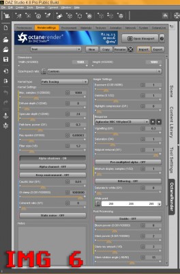

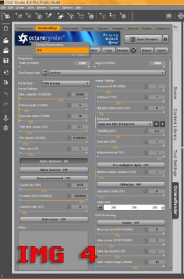

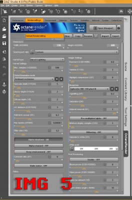

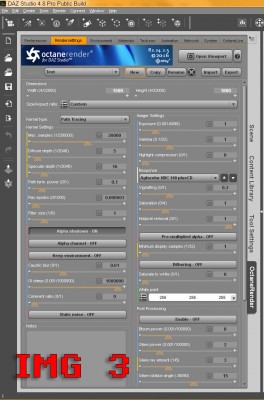

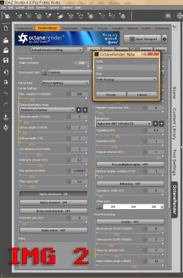

Hi Paul, sure, here my steps (ps I'm using DS 4.8).
Ps I really, really like to have the ability to open DazStudio and the octane pluging and have my settings ready. I just wish to change the main settings!
This is what I see as soon as I open DS
Now I'm ready to create my preset.
These are my settings.
I also try to export my setting.
This is what happen when I close and reopen DS. My preset is not longer here.
Now I tried to import my preset and it is not like the one had exported.

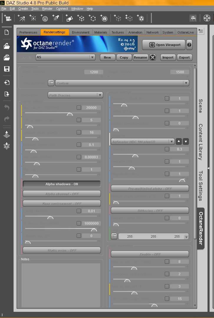

face_off wrote:I think your workflow is not quite right. If you click the '?' then render settings combobox, the help text explains you need to New, then Copy in order to get the new render settings in My Presets.
I've already tried that solution and this is what I get (right after creating it and also after restated DS) :
You then need to click copy. This is because the preset render setting is not actually in the scene at that point, so you need to copy it into the DS scene. If you had 200 presets - you wouldn't want all 200 loaded into your scene automatically, so you need to Copy.
Paul
