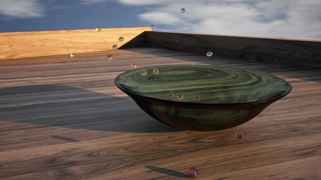

Hi, couple questions.
When I export 450 frames .abc from LW, Octane standalone gives me 161640 frames to export? How can I have 450 frames out, like it was in LW?
Then, there is this odd distortion, the balls should be balls, now they are distorted..?

ristoraven wrote: Hi, couple questions.
Are you using the last daily build 2.13.2? ... there are a lot of changes in the alembic export functions from the 2.13.0. In fact now you can export also a full .orbx file with all the shading information, not only the alembic file.

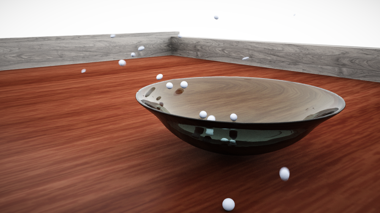

Now it gave me 374 frames out of 450. Still distortion in these fast moving pieces.. This is a test scene where small balls drops to a bowl, distortion seems to be related to the objects speed and roll?

ristoraven wrote:Hi,
Works better. Probably even better with LW2015?
Have you exported 450 frames and you only get 374 in Standalone? ... Perhaps there is problem with the fps in the Standalone, because I think that the export is made by time, not by frames. If you have exported the scene at 30fps, but standalone is set to 25fps you are going to get less frames for the same time.
If the balls have high speed rotations, try to set the "objects motion blur steps" parameter (in the render target motion blur options panel) to 3 or 4 before export the scene.

Yes, 374 frames out of 450..
I noticed that the pivot is off in the modeller from the balls, as a quick thought, might be that too?
I´ll play with this scene with different setups and frame rates. I´ll let you know.

Ok,
Correct fps fixed the frame issue, and the pivot fix did the job with distortion, at least in preview. Seems to work ok now.
