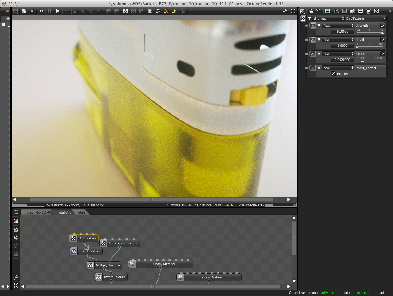

abstrax wrote:Ok, I just updated the Linux and Mac builds. On these platforms the dirt texture node should be available now.
it works now, big thanks :D
ciao beppe
