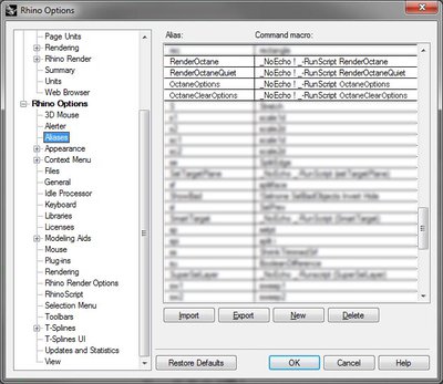

OK, now to make this a little more useable (all of the below is with only one instance of Rhino running):
Rhino Options -> RhinoScript:
Click the dotted box with a little sparkle on upper left (tool tip 'New')
Add the *.rvb files you unzipped from the previous message. Add all six, and be sure when you are done that functions.rvb is at the top of the list (so it loads first)
Rhino Options -> Aliases:
Create the following new aliases (remove quotes)
Alias: "RenderOctane" Command macro: "_NoEcho ! _-RunScript RenderOctane"
Alias: "RenderOctaneQuiet" Macro: "_NoEcho ! _-RunScript RenderOctaneQuiet"
Alias: "OctaneOptions" Macro: "_NoEcho ! _-RunScript OctaneOptions"
Alias: "OctaneClearOptions" Macro: "_NoEcho ! _-RunScript OctaneClearOptions"
Close Rhino, then restart and see if your toolbars now work. Let me know how it goes.

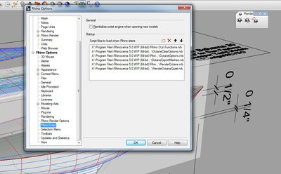

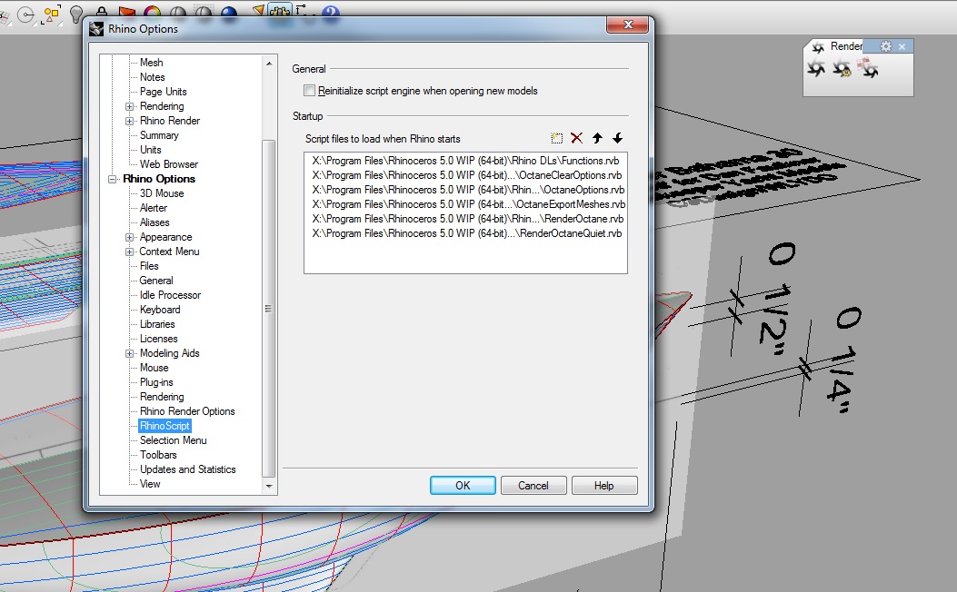

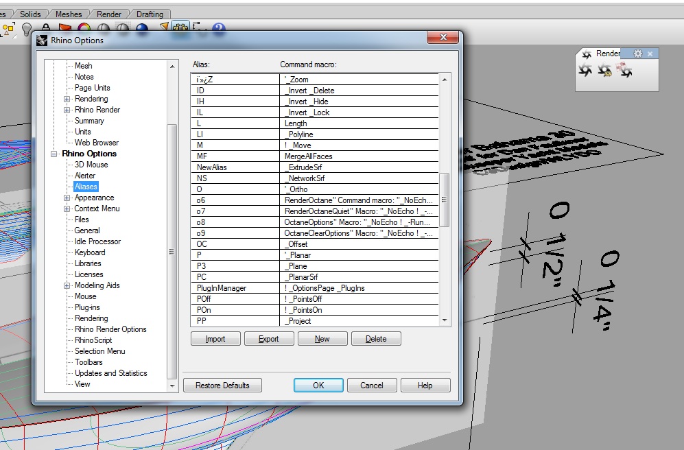

Not sure if I've done this right, Sam. I'm able to create the Load Script part, and then do the thing in the Aliases, but when I re-open the toolbar doesn't seem to make the connection or call up the script. I took these ss's to illustrate. Wasn't sure about the 'remove quotes' instruction...

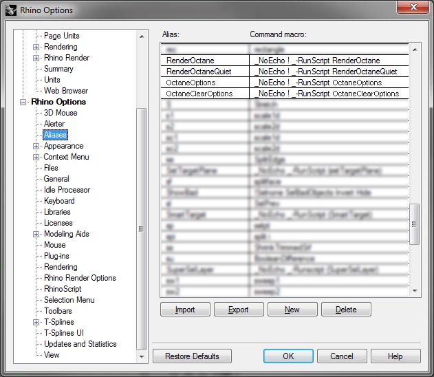

Ah, OK, yeah the Aliases got a little crossed. So where you have
o6 replace that with RenderOctane, where you have RenderOctane" Command macro:"_NoEch... replace that with _NoEcho ! _-RunScript RenderOctane
and continue with o7 through o9.
Win 7 64bit | 2x GTX 285 | i7 920 | ASUS P6T Deluxe | 12GB
Thanks Sam!
I know little about scripting, so thought I would be using a keyboard shortcut to invoke these commands so I used the o6 and so on not realising the way you link this stuff together. Works fine now and I've learned something about how clever this sort of stuff is. Thanks a ton, I'll try and not bug you for a while at least... How does stuff like this get broken with Rhino updates? Forget it, I'd never understand... Hope they are aware at McNeel. I just tried an old script for 'BoxFrame' and get the same sort of errors so I guess it isn't just your scripts affected. Your the best hope for the Rhino/Octane link, have any of the other guys that have expressed and interest made any progress?
