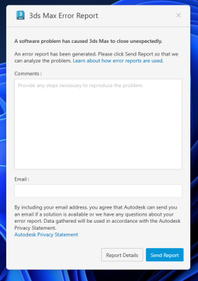

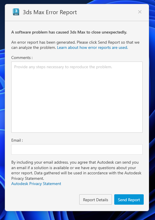

Sometimes crashes occur for no apparent reason when trying to run the render viewport, as in the previous build.
It doesn't give any errors, it just closes 3dmax 2025.

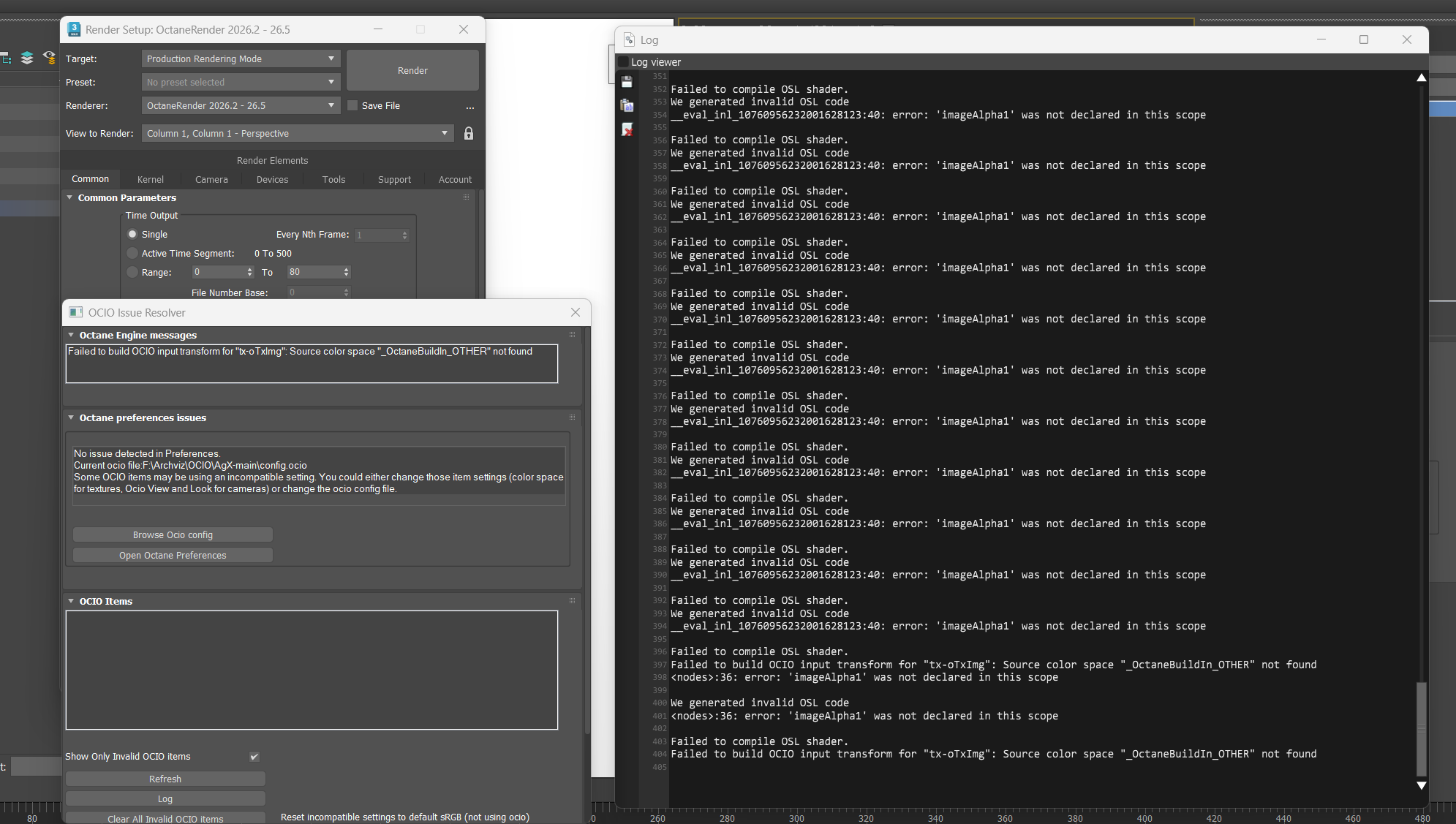

Thanks - any idea what the other issue though? Some older scenes not created in v2026 will not render.

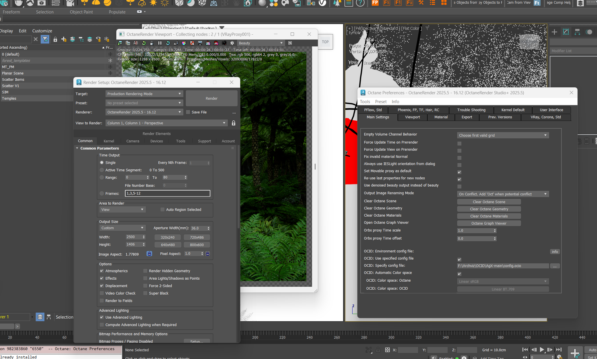

To confirm it is an issue with 2026, I reinstalled v2025.5 - 16.12.
v2025.5 - 16.12 - Scene renders in Octane RenderView just fine, no engine errors
2025 - renders
2025 - renders
v26.5 latest - Exact same file, but won't render and has engine errors?
2026 does not render

I have managed to reduce the error down to a single bitmap texture for debugging (however multple textures cause the render to not start, however not all of them)
See attached scene, I copied out a material from an old scene and on a new scene applied it to a plane.
To reproduce
1. Open file and try to render, it should fail with error
2. Remove the oXtxImg texture from the roughness slot and re-render, it should work
3. It complains about no OCIO file, however even with an OCIO loaded it still produces the error just a slightly different one.
4. The main error is this - Failed to build OCIO input transform for "tx-oTxImg"
I have tried to clear all the caches in preferences. But there seems to be some setting that cannot be controlled at the material editor level that is causing issues in 2026

tombyrom wrote: Mon Feb 23, 2026 10:23 pm
EDIT:
To reproduce
Hi tombyrom,
Thanks a lot for the scene!
I was trying many ocio settings, not couldn't find the issue..
All ocio settings work fine from version 2025 to 2026 (Color space in textures, ocio settings in camera)..
>> Except for 'Non-color data' !
This is not related to loading older scenes. You can get the issue with a new scene, if you just set 'Non-Color data' for Color space in a texture..
To fix this for now, just set any other Color space (sRGB, etc..)
I'll investigate more and will try to have a fix soon..
