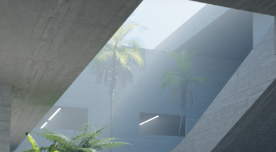

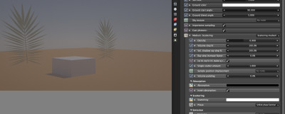

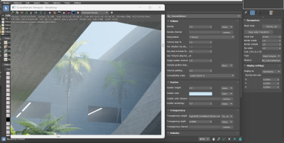

Hello guys,
There is an issue when using a fog volume and there are assets that use opacity maps, such as leaves
I have tried loads of different settings, even found this super old post from 2015 which was solved apparently.
viewtopic.php?t=49455
Attaching a scene for debug.
Tried Std Medium Volume and a normal Volume Medium, makes no difference, tried every setting on the leaf material and checked and re-checked kernel settings.
fogissue-max24.zip
(141.51 KiB) Downloaded 42 times

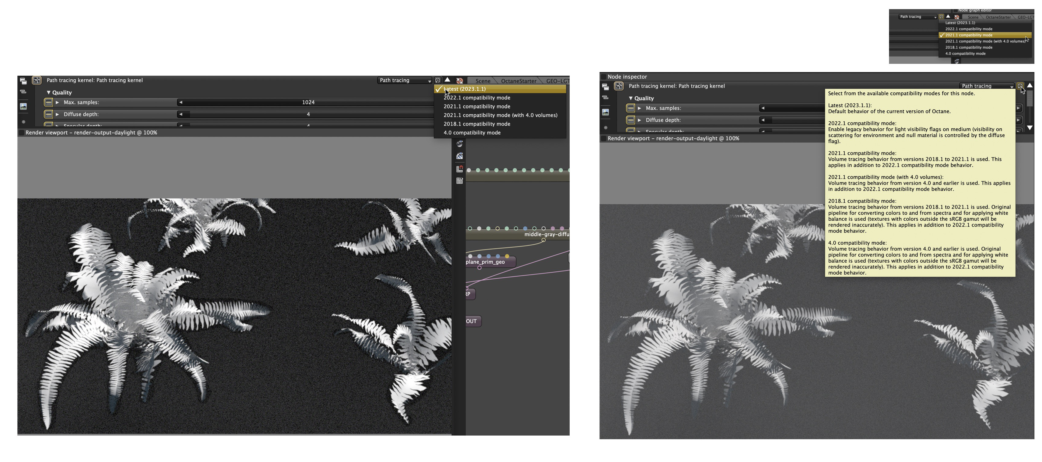

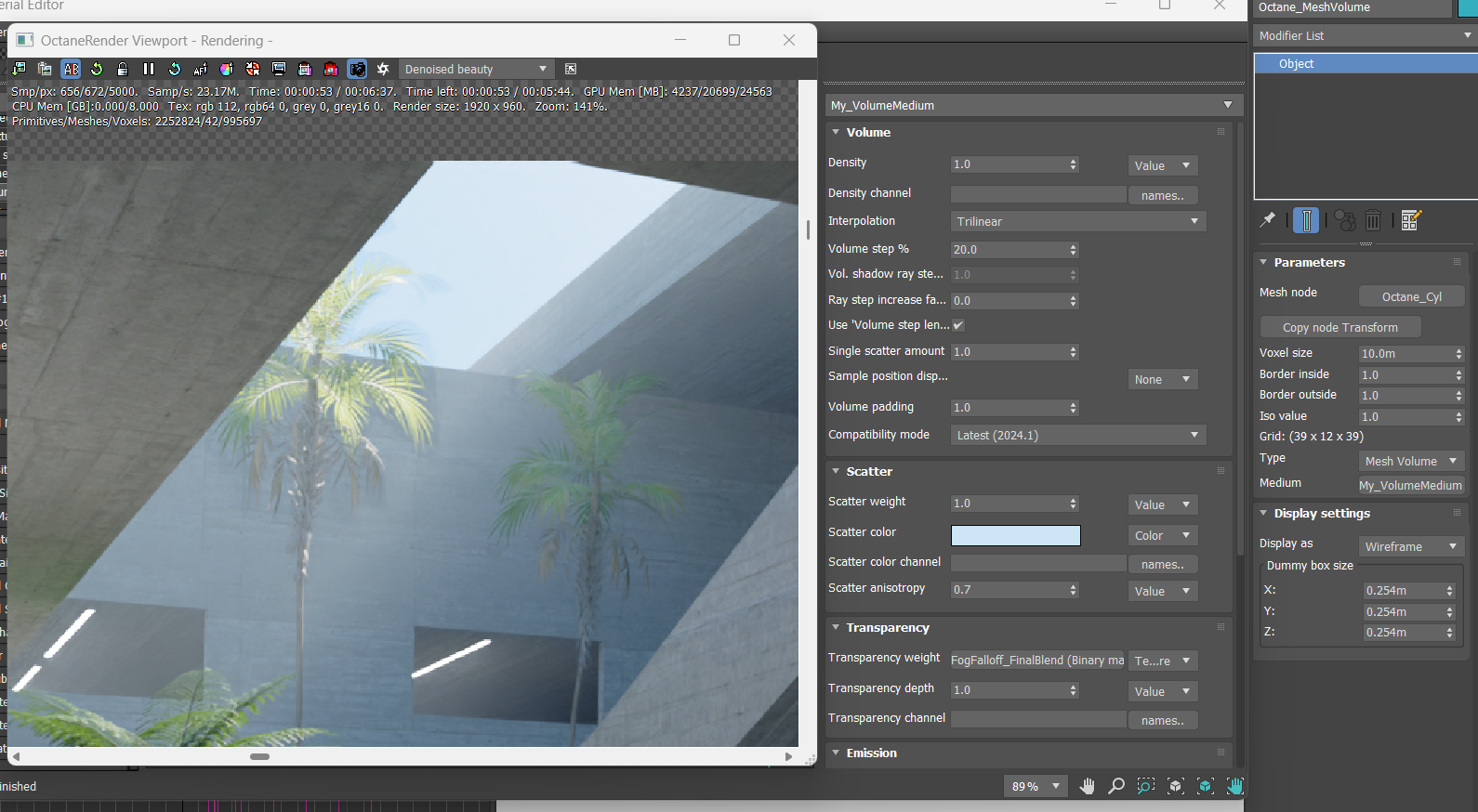

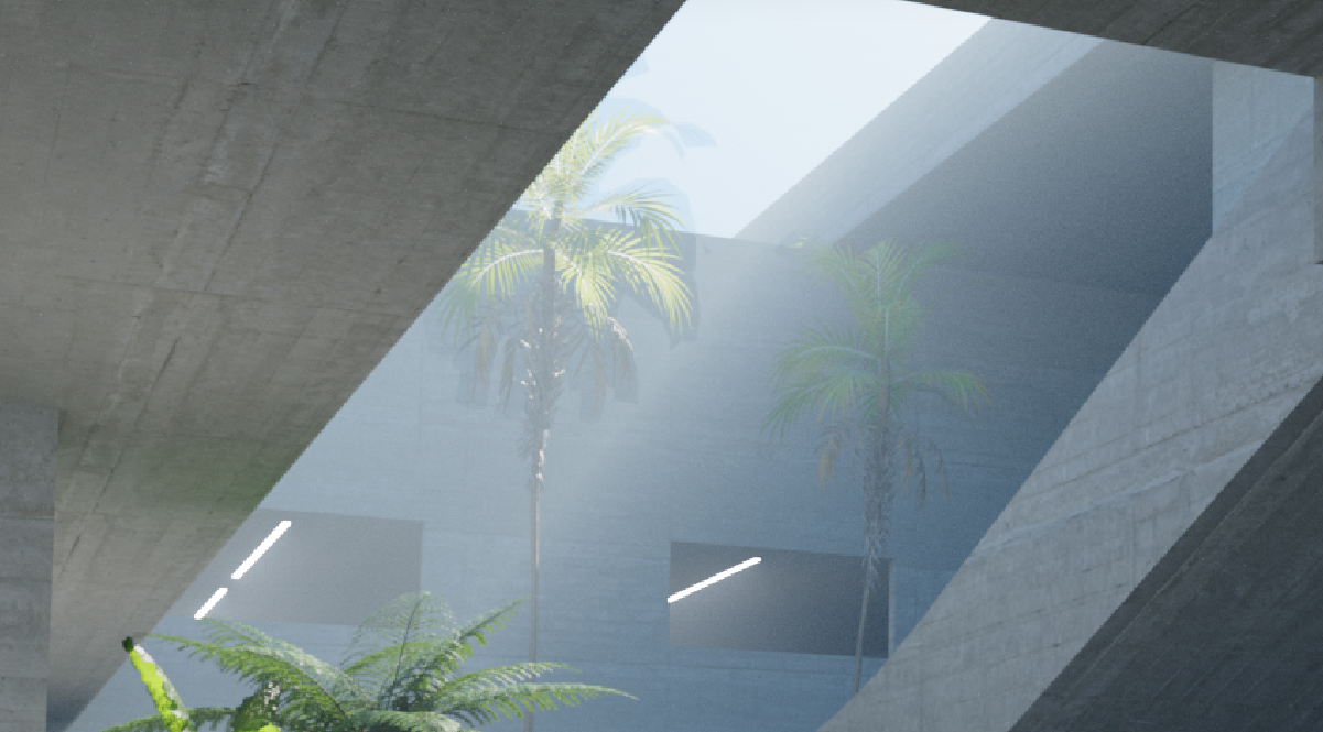

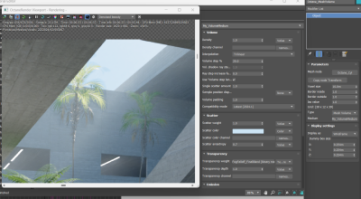

If you use the Std Medium Volume in compatibility mode, it is a lot harder to replicate this problem.
So the issue has to be tied to the fact that the ray march is no longer tied to an absolute length and rather a % based on voxel size.
If I change my voxel values, volume step %, density and transparency I can reduce this problem but I would not go as far as saying this is a fix as it requires very specific manipulation over multiple values to get the fog look you want and to reduce this problem.
See screenshots, it is still not perfect and can still make out some a slight border

The 3dsmax scene above shows it more easily as you can easily control the voxel size of the mesh volume.
The bitmap map is not the cause, just swap it for any procedural texture and it's the same issue.
I believe the issue is linked to the volume step % and how the ray calculates opacity through the volume, causing inaccuracies with a larger ray march relative to voxel size.
You need a really low step % relative to voxel size and then change the density and transparency to get your desired fog look and reduce this issue.
So the answer I'd like to know is whether this is a limitation of how raymarching works? Or is there something in Octane that can help deal with this.
Reducing your step % is all well and good, but it increases performance cost exponentially and it is only masking the underlying issue.
fogissue.orbx
(2.64 MiB) Downloaded 42 times
