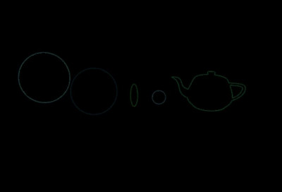

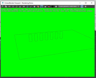

I made a test I got :

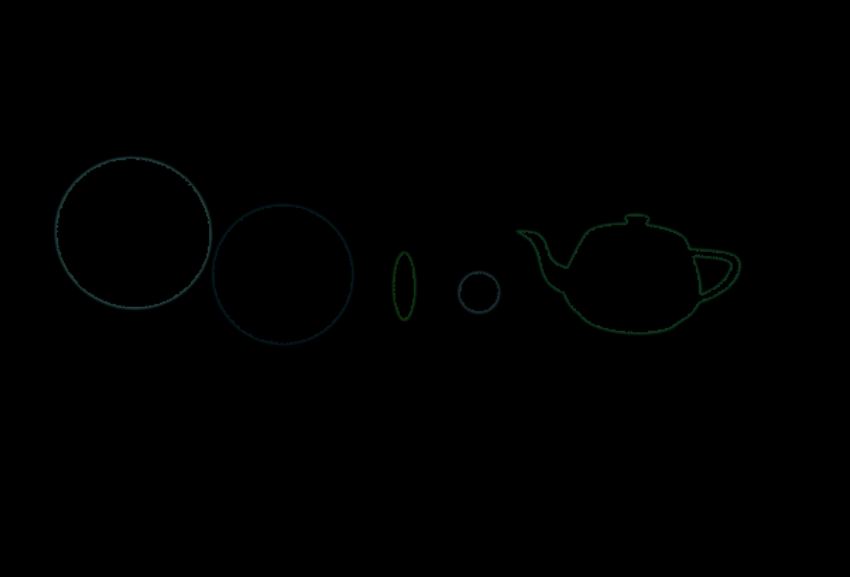

I use your file is ok, but when I render with "save all render passes as a single multi layer EXR file" I get :
and when I use new cryptomatte node in Resolve 20 I get : ( no surface, just edges )
The attachment resolve.JPG is no longer available
It is better to use Octane EXR or MAX one ?

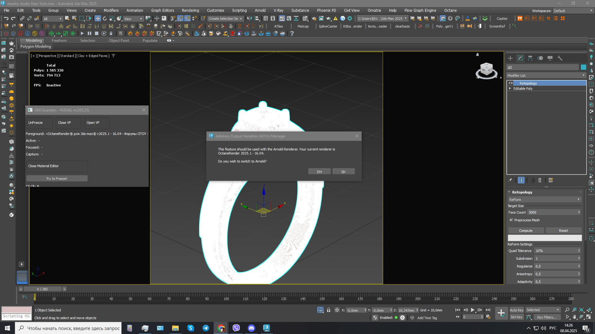

If I try to add any modifier to an STL file with the Octane renderer selected, it can freeze, and after thinking for a long time, this panel popped up for me
Here is the file in the archive, the ring model is not mine, I was only given the opportunity to render it. Maybe there is something wrong with the STL

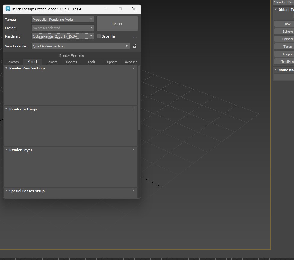

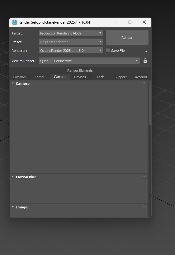

Hello NeonZorglub,
Not a big issue but I still have the empty tab problem on max 2024 (latest updates), 572.83 Studio Drivers.
3ds Max is freshly installed, it happens every time on new scenes

Elvissuperstar007 wrote: Tue Apr 08, 2025 11:29 am If I try to add any modifier to an STL file with the Octane renderer selected, it can freeze, and after thinking for a long time, this panel popped up for me
win10/ nvidia 4090/ xeon e5 2690 v0 (AVX1) 64GB DDR3 1866 (quad channel) ssd SATA Sumsung EVO/ Game Ready 572.83/ be quiet! Straight Power 11 Platinum 1000W
Hi Elvissuperstar007,
I can't reproduce your issue using your scene. From the screenshot, it looks like you're using the retopology modifier. I tried using that as well, but aside from a few freezes that I can resolve with the unfreeze button, I haven't experienced any permanent freezes. This modifier takes some time to update the changes, but I haven't encountered any pop-up windows like you mentioned. Do you have other applications using the GPU and VRAM (like Chrome, for example)?

paride4331
Posts: 4001
HHbomb wrote: Tue Apr 08, 2025 9:54 am Hi NZ !
Hi HHbomb,
Did you set the 'Rendering Toon Map' option to LDR in the Render Settings panel?
Regards
Paride
HHbomb
Posts: 1438
Hi Paride. No it is set to HDR
paride4331
Posts: 4001
HHbomb wrote: Wed Apr 09, 2025 12:56 pm Hi Paride. No it is set to HDR
Hi HHbomb,
You should use LDR with cryptomatte layers
Regards
Paride
HHbomb
Posts: 1438
What about image quality with LDR ?
