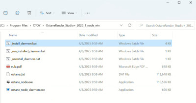

Thanks for all the info.
So I'm starting a new work and installed the daemon node thing,
but as soon as I launch it I get the message "Daemon startup script does not exist. Please install the daemon first."
Which is what I just did...
Any clue on what to do ??
I'm about to buy a GPU for an extra node so it better work!
I have to render from an alembic particle sim weighting 240Gb, so there is no way I can render this online with the catastrophic internet bandwidth i have...
Posts: 10611
Hi Jukyan,
just to be sure, did you run the "_install_daemon.bat" script first?
ciao,
Beppe
Jukyan
Posts: 28
Joined: Thu Nov 03, 2016 3:18 pm
Thank you Beppe & everyone, it works like a charm :)
