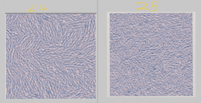

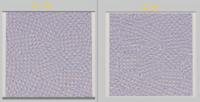

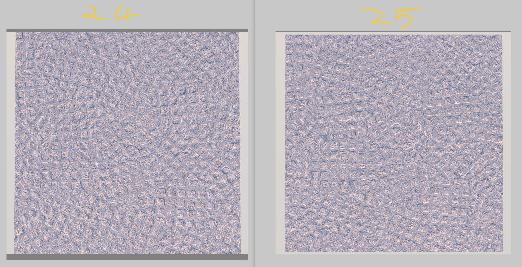

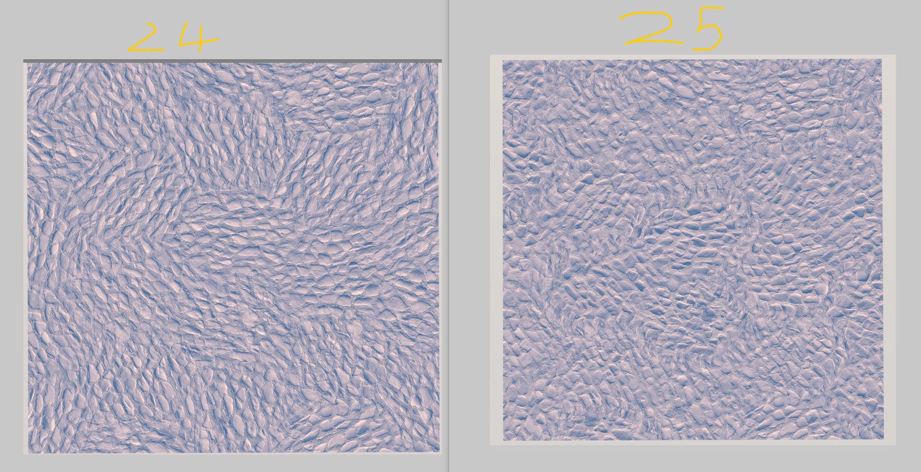

Thanks, I just tested a few real use case normal maps and compared to 2024 they DO LOOK CORRECT. No idea why that test normal map above is giving the impression it is not working, but shadows are in random places. You can just download the image above and add it to your scene if you want to see yourself.
Sorry for wasting your time and thank you for getting this fixed!

OK, the first one you posted appears to be a DirectX style Normal map. To make it work we must invert the green channel.
But we have to do this on the raw data before it gets linearized by the engine. Set it to "non-color data", add a "Channel inverter" node and set it to invert the green channel, add a "Color space conversion" node and set it to "sRGB to linear sRGB". Then plug this in the Chaos texture and it should work.
