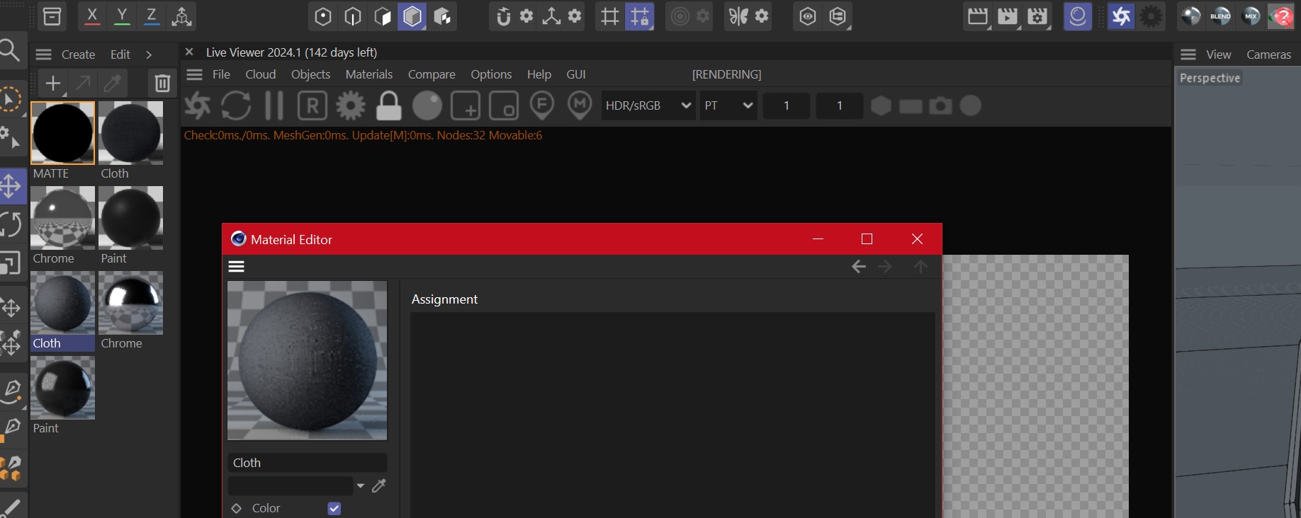

Hi, Aoktar.
Apparently the "Remove unused Materials" command is not working on C4D 2025. Not sure about other versions.
What about the "Real-time Rendering" toggle switch in Standalone? Does C4D version have one?

Remove unused Materials command not working
