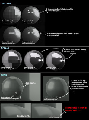

Thanks for the infos Radiance, very instructive about low polys. ;)
With this new informations, I gave another try today and...I'm very happy because I found how to use Octane with Lighwave for animation !! :D
My pipeline is Messiah Studio for rigging and animation, export .mdd to Lightwave, then add an displacement mapping to use my Zbrush sculpt and finally use the holocube's exporter....and it works very well.

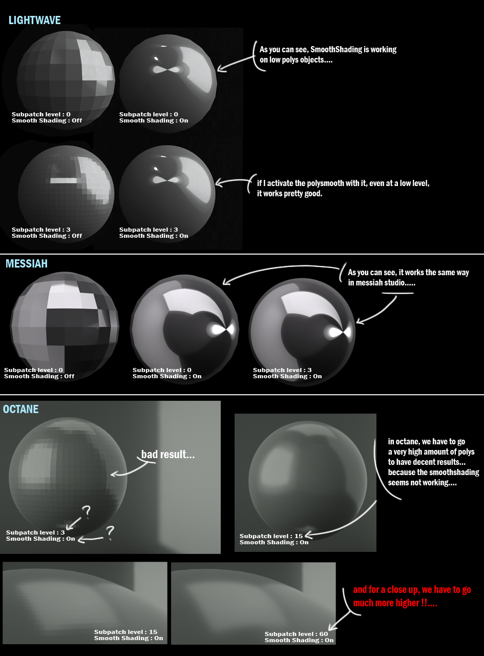

Yes...you're right !!
In fact I can have a good result with smoothed surfaces, but it needs a very high count of polys !...which is bad for animation production .
I don't know if the problem is coming from the exporter or Octane, but we clearly need an update to add Octane in our pipeline production !
I did some little tests here, that shows that Lightwave and messiah can easely do smooth shading on low polys object !!
I'm sure that Octane can do the same...there is a bug somewhere.
Please Radiance, we really need your help ! :|

This is indeed what i suspected and is a bug in the lightwave export script.
The exporter does not write out vertex normals properly.
We're doing our best to get holocube to provide a fixed version of the export script asap.
I have not gotten a reply, will try to call him via phone again tomorrow.
