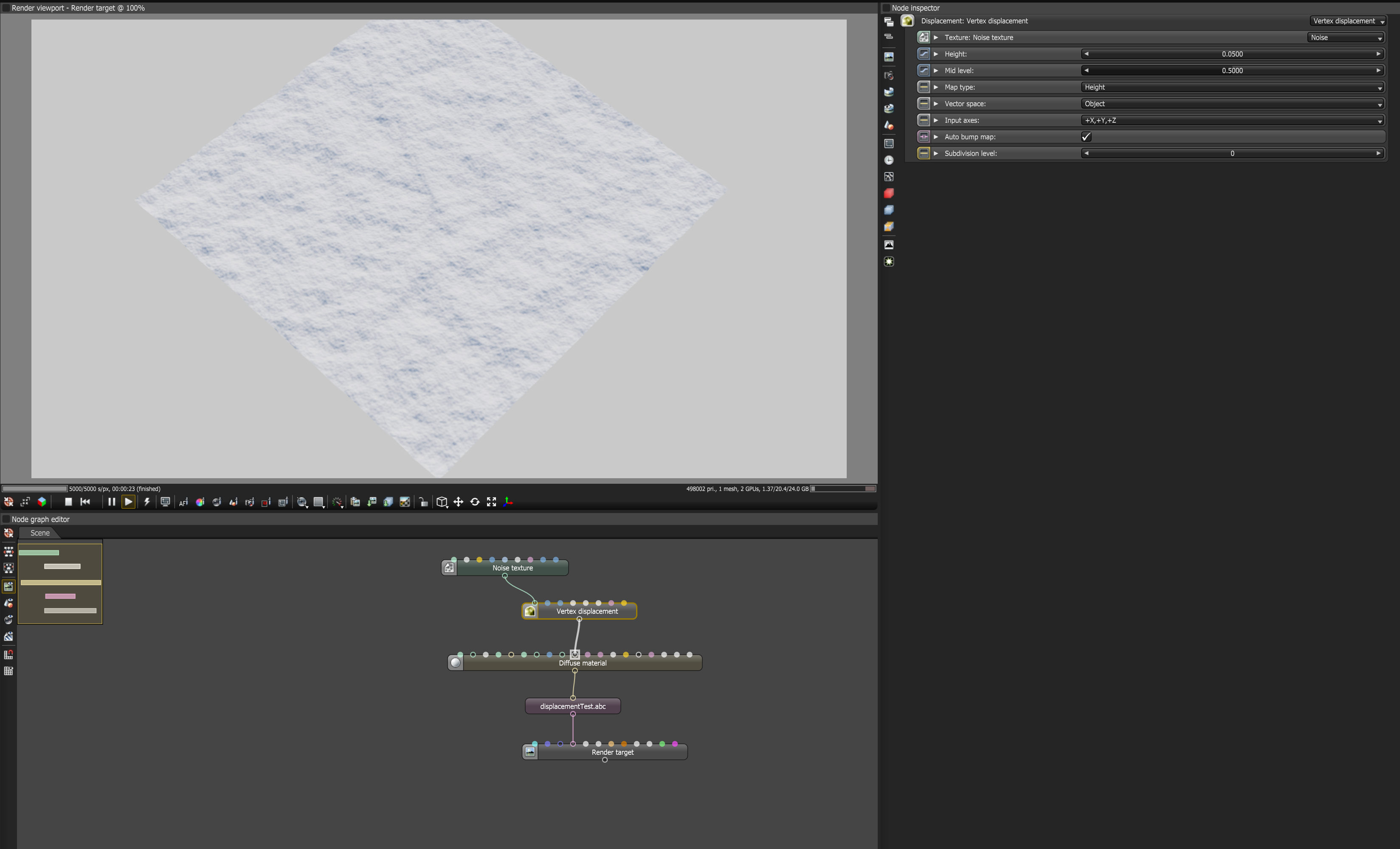

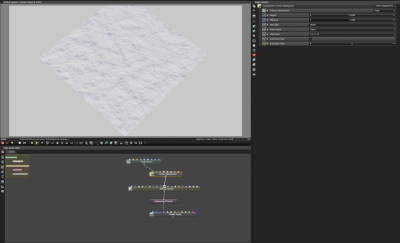

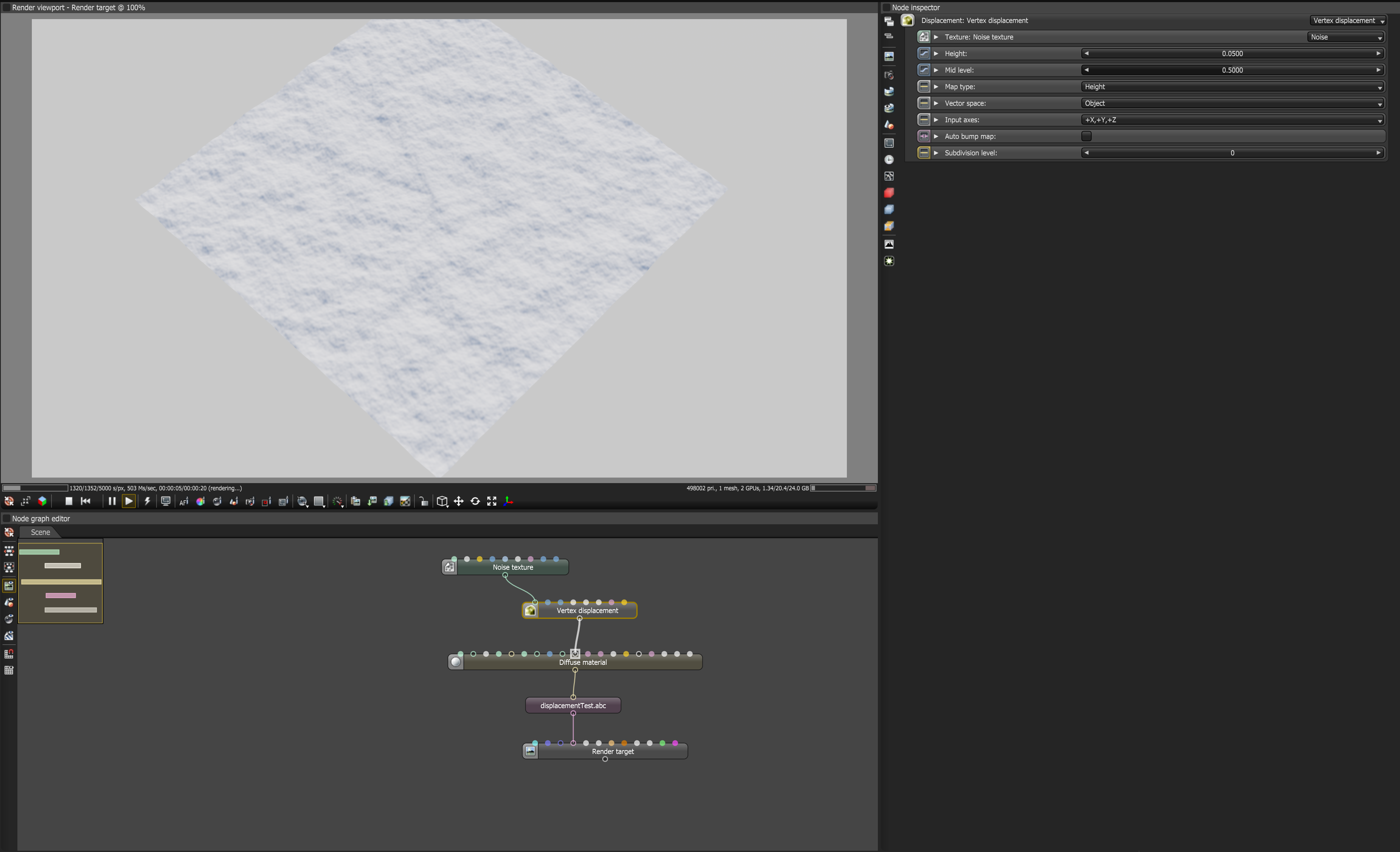

Hmmm weird cause it worked for me in 2023.1.2. I exported the grid from the hip file and assembled the scene in standalone. It works as expected.
auto bump OFF
auto bump OFF
auto bump ON
auto bump ON

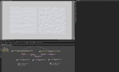

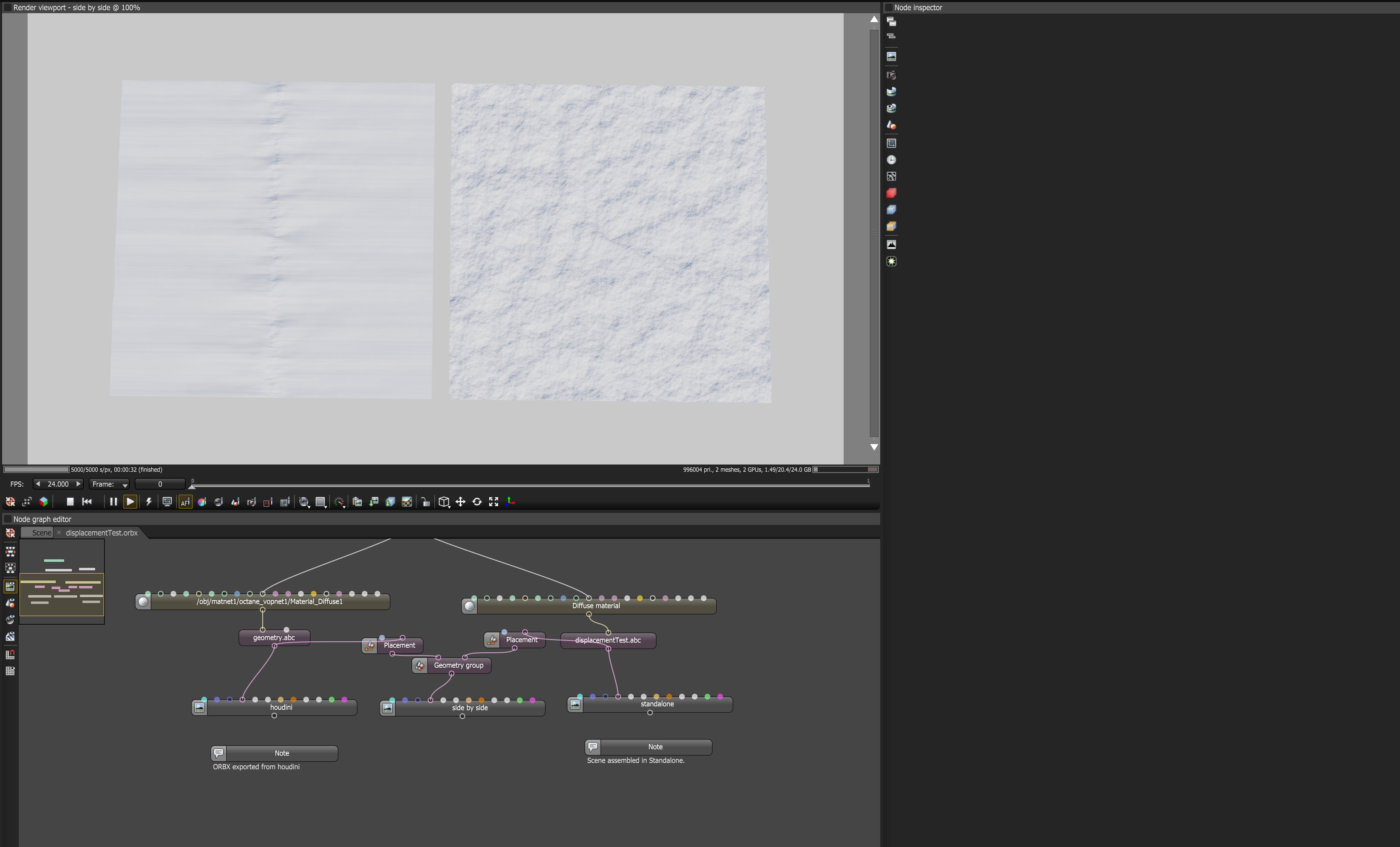

It doesn't work when exporting as ORBX. Here is a side by side comparison. (left is orbx, right is assembled in standalone).
But anyways, adding UV Mesh Projection fixes the problem so thanks for that.

Ok thanks for the additional, yes I see the orbx export vs. exporting the ABC from houdini file produce different results.
Will log an issue for it, thx!
