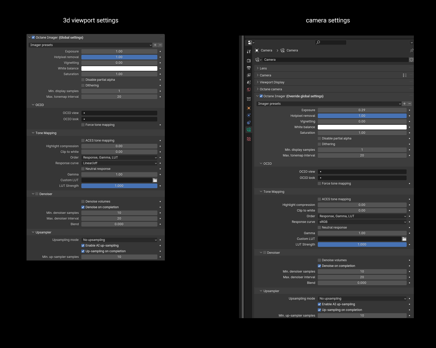

This is what I proposed. Enabling Imager on Camera object disables the Global imager in 3d viewport panel but only for this specific camera. I don't see a point of having extra scenarios you described. This one will be enough.ad 3) When the checkbox in the camera imager is checked, it will always use the camera imager settings. No matter what is set in the preview. If the checkbox is unchecked, the camera imager will use the preview settings. In my suggestion there is no way to have the preview settings override the camera settings if the checkbox is checked. But that would in fact require additional checkboxes. But then we risk the extra confusion again.
Also there should not be any Preview or Render mode labels but Global settings and Override:

I don't want the Imager to be removed from 3d viewport window. It should stay there as it is now. What I'm saying this should called "Camera Imager (Global Setting)" and be used for all cameras that has no imager enabled in Camera object properties.

Not exactly like that. You have added unnecessary option to enable or disable Imager on camera object and removed the toggle to disable Imager completely.

Take a look how it is done in C4D with Octane plugin or Redshift. There is a global camera imager settings for all cameras or an override in active Camera object. It can't be any simpler.
