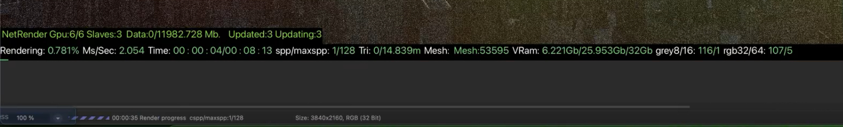

I don’t think it’s network speed, everything wired by LAN.. I also have another Mac ( cheese grater) high sierra that runs the super old version that supported network rendering to PC, and that works fine. All connected in the same manner via a local LAN.
Any more thoughts on the problem?

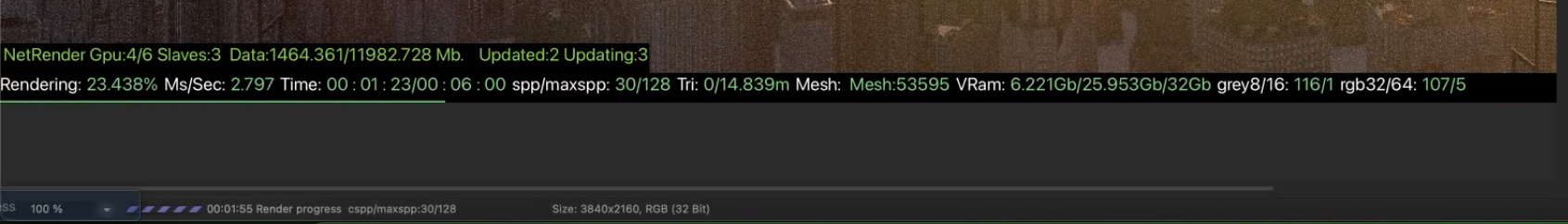

Hi Raoul,
the network interface speed seems slow in your screenshot.
Here is a KitBush scene greater than yours with 10Gbit Ethernet, after 4 seconds the Render-Nodes are already rendering: And here is the same scene but with 1Gbit Ethernet, the Render-Nodes are starting to render only after 1':23": Please go to System settings/Network/Ethernet/Details/Hardware and check that everything is correct.

Hallelujah, Thanks.. this prompted me to dig a little deeper. I was wired for lan on the Mac studio.. but looks like it was still using the wifi connection. Switched that off and bingo. Cant say how great it is to finally have network rendering enabled.. that issue alone was keeping me stuck on a 10 year old mac pro that could still run nividia.bepeg4d wrote:Hi Raoul,
