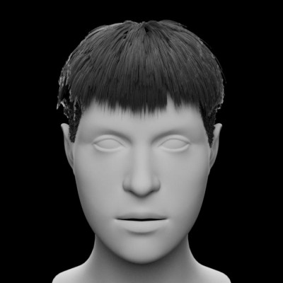

Hi Ricky,
I have a test scene for you, where it's pretty obvious:
https://1drv.ms/u/s!AiO-yRNxbYloi2fUrIA ... n?e=DLE3lL
Lighting is symmetrical but reflectivity and scattering isn't, no matter the offset value:
Do you have any estimates, when you have time to look at it? Currently starting lookdev for this project and the hair is important. Already tried the standard and universal shader with anisotropy and all kinds of sss. Reflectivity looks good but I can't achieve that plausible softish backlit effect with standard sss. It keeps looking too rigid and wiry.

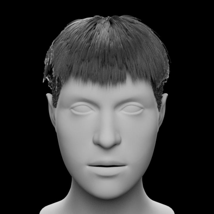

Hey thanks for checking it out! That doesn't sound great, if it's a Standalone issue..
Unfortunately mixing isn't an option. We have a few pretty symmetric shots, so you can easily spot that strange behaviour.
With this lighting you can see it even more. and that's rendered without specular. What's weird also is that albedo-mode behaves quite differently to the melanin-mode:
And if I'm in albedo-mode an set albedo and specular to black, it still doesn't render black:
I did a quick test in Redshift for comparison, this is more what I would expect:

I am not sure if you received my PM and test scene, but it seems this may be a bug in Standalone which will be looked at.
The QT5 render window (Always on top) will be set to default: off for the new production build due this week.
