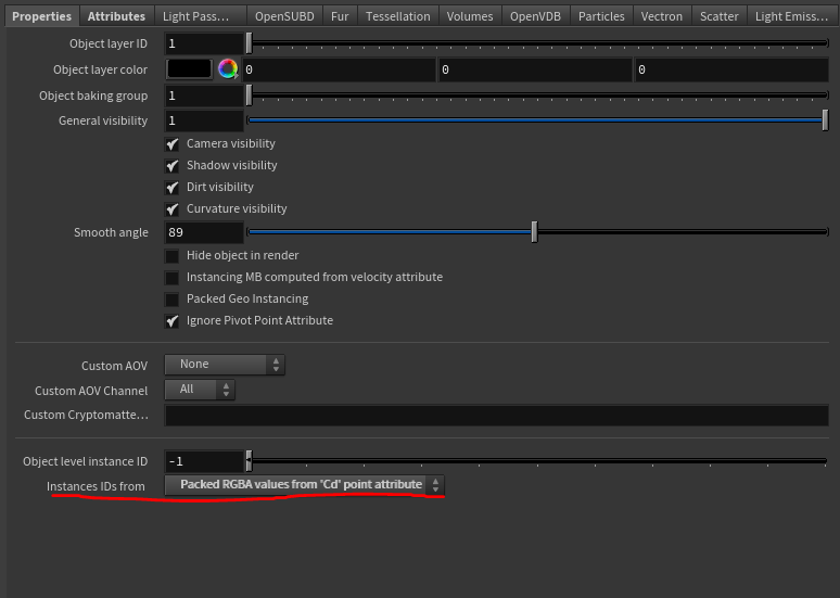

lavrenovlad wrote:@Cd attribute via rgb4k_map.ppm doesn't work anymore.
If I create a bunch of instanced objects with @Cd attribute on them, using that rgb4k_map.ppm doesn't instance the colors from particles onto these instances..
Change Instance IDs from to "Packed RGBA values from 'Cd' point attribute.

Nice, thanks for the info! Wasn't that option the default before?

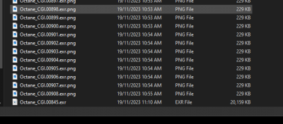

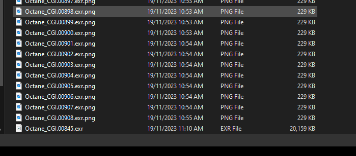

We're going to roll back to the 2023.1 build. Now we're seeing images rendered out as ".exr.png" files via Deadline. Rolling back sets the format correctly and allows us to continue.
ricky_otoy
Posts: 289
Joined: Mon Jun 19, 2023 6:34 am
Renbry wrote:We're going to roll back to the 2023.1 build. Now we're seeing images rendered out as ".exr.png" files via Deadline. Rolling back sets the format correctly and allows us to continue.
Hi thanks for reporting, will be looking into it. It may be from a fix for multiple ROPS but was sure this was working.
