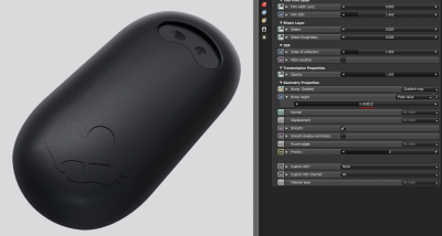

sethRichardson wrote:Seems like bump mapping in Octane is having some issues.
I think that you have too small "bump height" ( which is not height but some of the semi-blur effect ) amount and try lower bump strength/amount in bump image node.
Generally bumps in Octane have issues because they are too harsh. It cause errors during rendering especially if they are very dense. Octane really needs true gaussian blur option for them.
Bump Height is misleading - this is not height but as I see it mimic blurring by moving bump samples outside of its centre. Bump height is done by bump image strength right ?

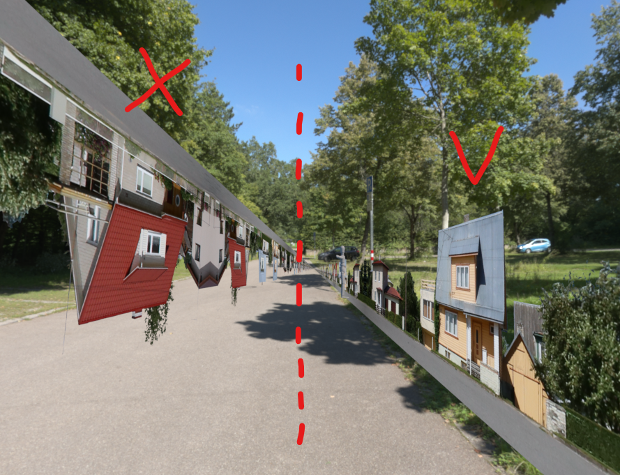

Perspective projection issue. It create mirrored by U and V axis copy of the same image :

SSmolak wrote:Perspective projection issue. It create mirrored by U and V axis copy of the same image :
Can you provide an ORBX so we can take a look at it? Thanks

john_otoy wrote:Can you provide an ORBX so we can take a look at it? Thanks
Sorry my fault, it was caused because I doing this inside HDRI Environment object and it needs to be clamped by gradient.
