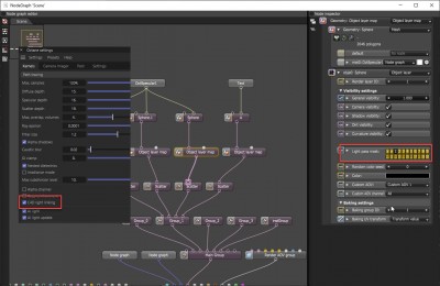

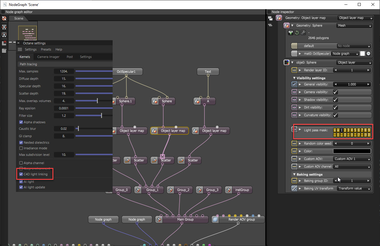

haineicunzhiji wrote:When a luminous object is placed inside the glass, abnormal luminescence will occur. As shown below. This situation can occur in:
1. When you save
2. When you adjust the glass color,3S property
3. When you adjust the brightness of the luminous object
4. Refresh the preview window
5. When moving the lens, the object
Anyway, this kind of loss of glow happens all the time!
[img]
The attachment Snipaste_2023-08-13_12-44-36.png is no longer available
[/img]
Under normal circumstances, this should be the picture below.
[img]
The attachment Snipaste_2023-08-13_12-15-48.png is no longer available
[/img]
So, I had to go back to 2022.1.1-R6
There is a problem with "C4D light linking" option and the scene. If you resend the render or disable the option it works fine. I'll take look for the problem. See picture

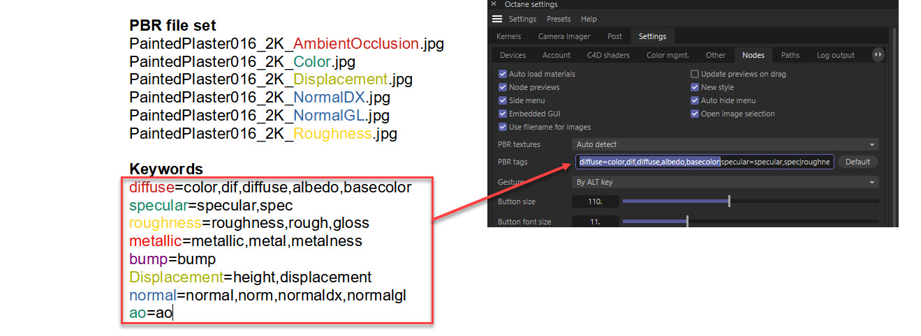

hey Aoktar!
I'm happy to hear from you!
I tried, but dragging and dropping a texture over material node in amterial editor doesn't make anything, just adding a texture node.
I'm sure I'm doing something wrong, but I don't know what :)
Thanks and have a great day!
Posts: 16068
Location: Türkiye
shine71 wrote:hey Aoktar!
What's the texture filename? It knows that by checking the filenames and file sets to know that's a PBR texture group. See the picture for naming syntax
shine71
Posts: 138
Joined: Sat Mar 15, 2014 5:16 pm
Hey Aoktar!
Thanks so much!
My fault was to not delete _4k suffix, thinking that was enough that channel anme was included in file name.
Deleting it, it works and it's great!
Thanks again, as always, for your support!

How was the file names for set with _4k? You can add new keywords in the settings. Thanks for your kindness

Yes, you're right, I should understand what's the best workflow to use this feature and optimize time.
anyway, it's great! :)
