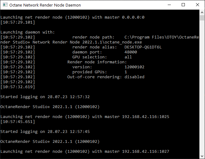

The Viewport render works with the **Render Node**, but the **Render Node** doesn't do any work, when I use "Render to Disk" or "Render to MPlay".
I've attached the **Render Node** Log. While it rendered with the viewport, there is no entry about that event.

hi Cyrill,
Thanks for sharing the log file. Looks like the render node did not receive any data to process.
Would you please check if the master node sends data during the Viewport render?
The log should have time..ip etc..
We need to leave the **Enabled network rendering** and the **network daemons** options checked/enabled.
This way Render to disk command can pick up the render node automatically!
If this does not work then we recommend checking the Windows firewall or antivirus blocking the data transfers.

Hi Cyrill,
Thanks again for the screen recording. It is very helpful to understand.
Would you please check the messages from the RenderNode dialog instead of the octane daemon log?

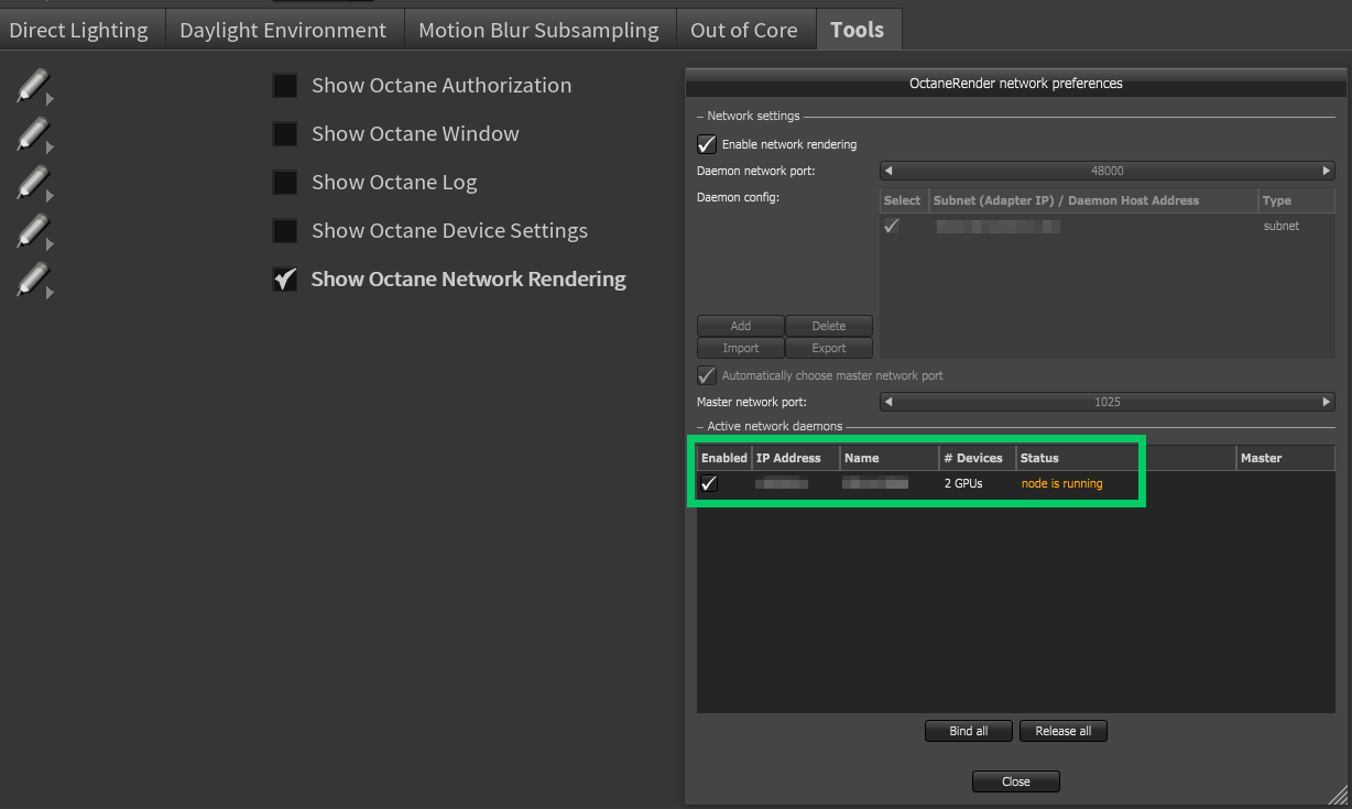

Hi BK,
Also with an animated scene the RenderNode is not participating in the rendering.
Attached a screenshot of the RenderNode dialog (I verified, that the rendernode participates, when using the Viewport).

Hi Cyrill,
Thank you for attaching the screengrab.
It looks like the Render node is connected! Did you happen to check the GPU stats?
Is it okay to reach out via Zendesk "[email protected]"?

Hi BK
As seen in the video, I always check the GPU load - thats unfortunately the only indication, if the node does its work.
Ok, I'll reach out via Zendesk.
