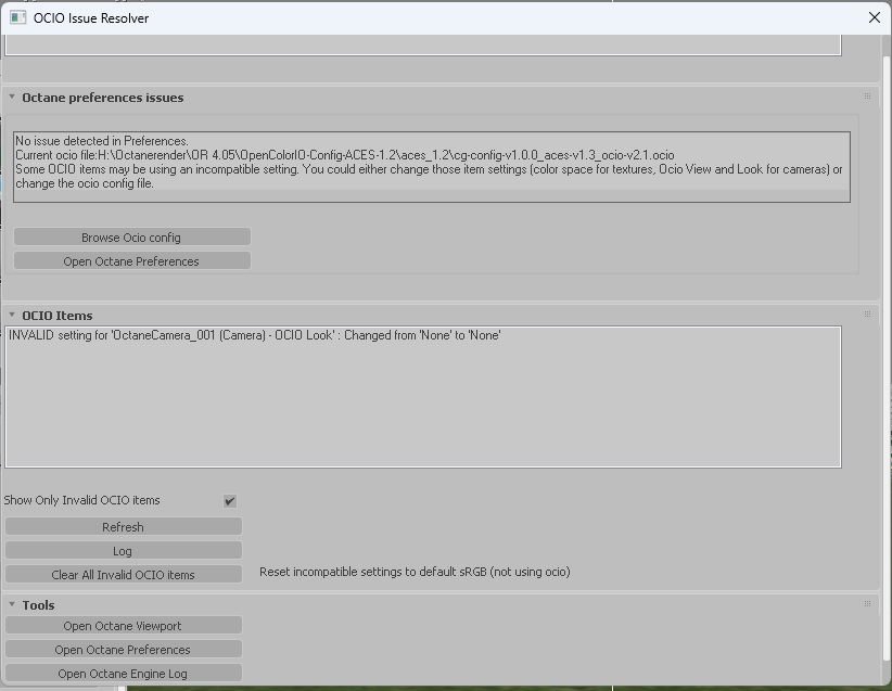

merid888 wrote:Hello, good morning OctaneRender team.
I have a problem when I try to use Ocio config it crash the Octane Vewport Render
Add image like reference

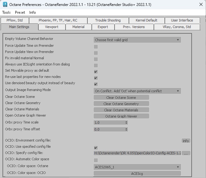

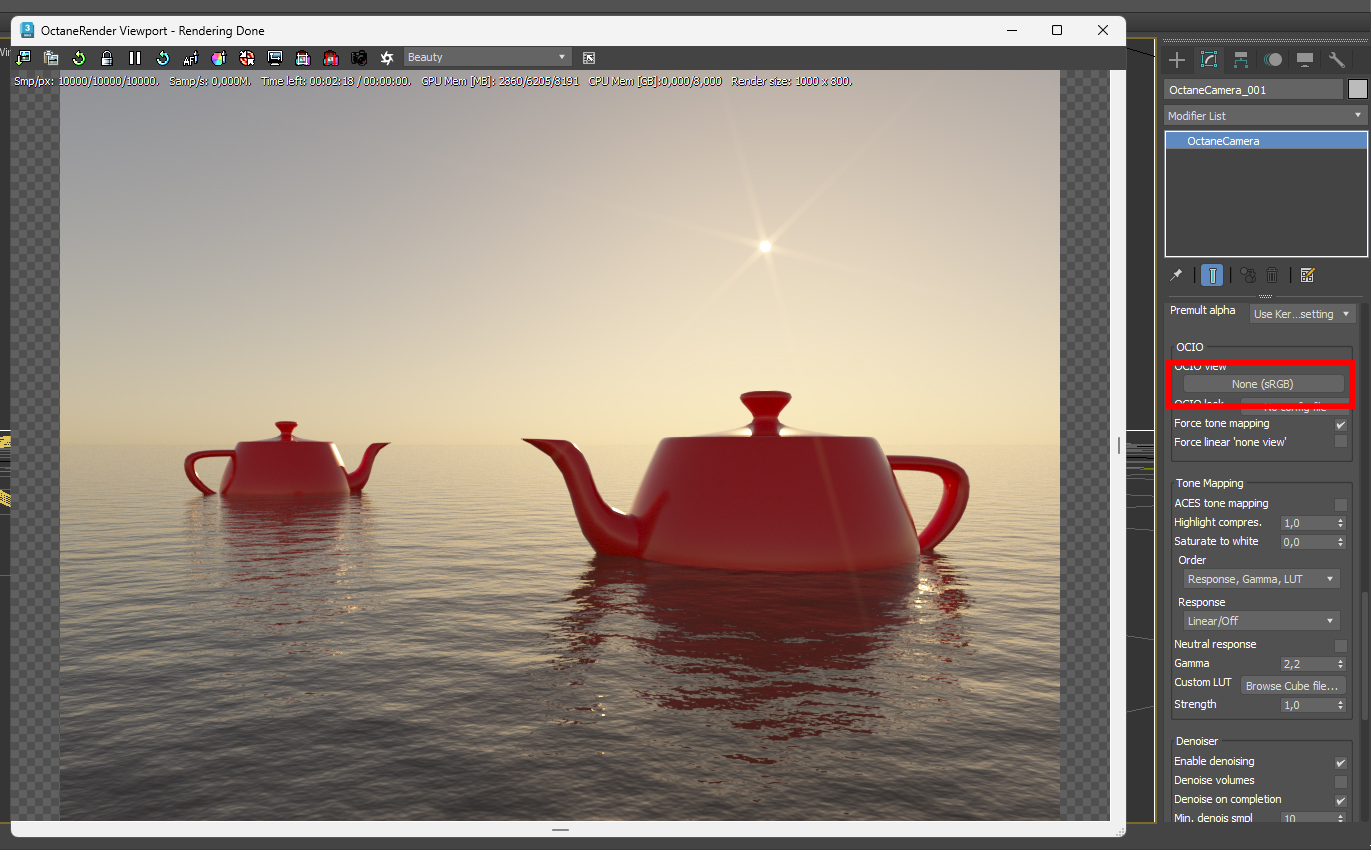

I been followed the steps just like the link like you post. It's been configurated correct.
I mean, what it is Acescg ? Becouse I read one and over and over again and I put in practice about the tutorial but I can't do a realistic image
Attached reference so you know what I am talking about

paride4331
Posts: 4001
merid888,
Your issue is due to the fact that you activated ACES tone mapping without actually setting it up. As you can see in my screenshot, I have deselected that option. Additionally, I changed the type of the sun system and set the sea as an infinite plane.
Regards
Paride
