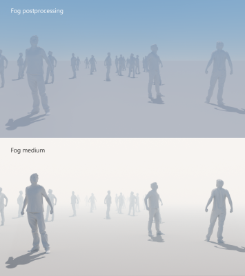

2. The fog you have introduced is pretty useless as it just dims the image pretending to be a fog. There is no distinction in density between objects in front and far from camera. All have same amount of "fog". I've tried different settings but cant get the same look as with medium. As an example I attach a picture with a medium render and "fog". There is also orbx file to check the issue.

J.C wrote: 2. The fog you have introduced is pretty useless as it just dims the image pretending to be a fog. There is no distinction in density between objects in front and far from camera. All have same amount of "fog". I've tried different settings but cant get the same look as with medium. As an example I attach a picture with a medium render and "fog". There is also orbx file to check the issue.
The attachment fog.png is no longer available

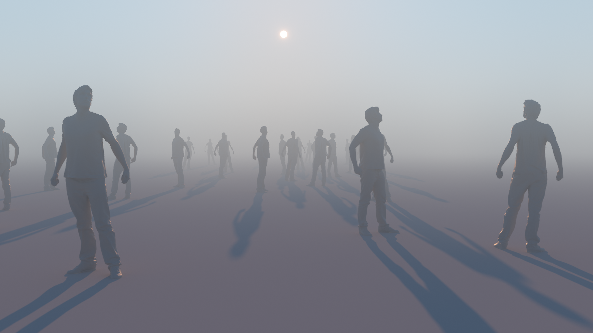

Hey J.C, please consider that the balance between the Fog Strength and the Medium Radius is pretty important.
That's what I was able to get:
I'm pretty sure you can get close to that in your scene as well. The post process fog definitely does well more than "just dims the image pretending to be a fog".
Hey J.C, please consider that the balance between the Fog Strength and the Medium Radius is pretty important. That's what I was able to get:
Could you try my scene? I can't get it working to look as with medium or similar to your scene.

For some reason to make it work I had to copy/paste your objects in a new scene. Did you export the scene from a DCC?

Got it working after removing object with specular material in front of camera. It somehow interferes with this effect.
There is another issue I've found. The fog is causing non aliased edges on objects in fog:
