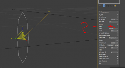

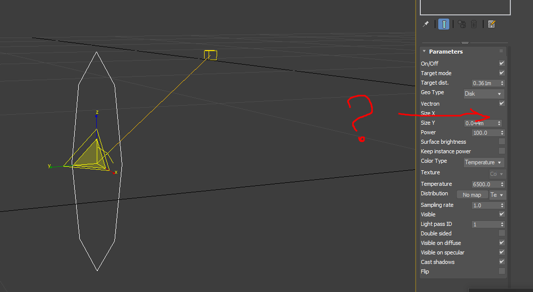

Where is the "Size X" parameter in octane light ?

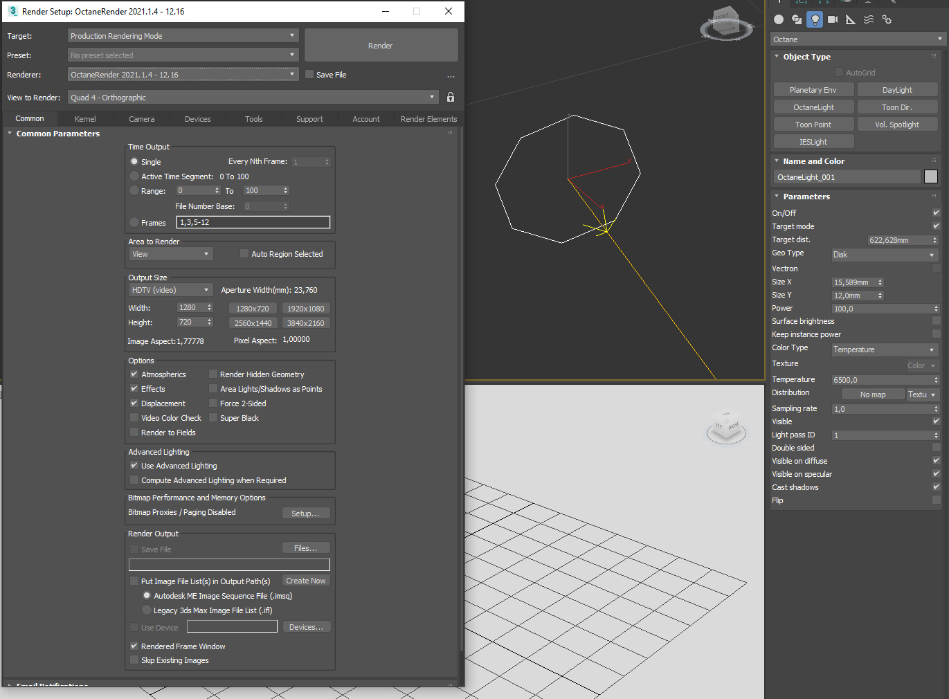

Hi Alminia,
I can't replicate your issue, are you sure you're using v2021.1.4 - 12.16?

Alminia wrote:Where is the "Size X" parameter in octane light ?
Hi, Alminia,
Thanks for reporting this issue.
You have enabled the experimental 'Expand Object Dialogs width' I guess.
There are still some issues with some objects, like this..
(This happens when you resize the dialog)
Turn it off (Preferences / User Interface / Expand Object Dialogs width), then close and reopen the dialog.
This should be fixed in the next release.
Hi, Alminia,
Thanks it works !

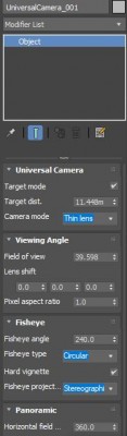

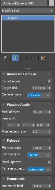

Also there are settings that are underlined in blue for no reason in the universal camera settings.
It returns to normal if I disable the above-mentioned option in the user interface settings.
