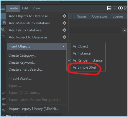

Ha, probably because I used Xref as object from Asset Browser library :) So this is the same problem.
Architectural Visualizations http://www.archviz-4d.studio
Posts: 16068
Location: Türkiye
SSmolak wrote: Ha, probably because I used Xref as object from Asset Browser library :) So this is the same problem.
Sorry I don't know how can you use it like that

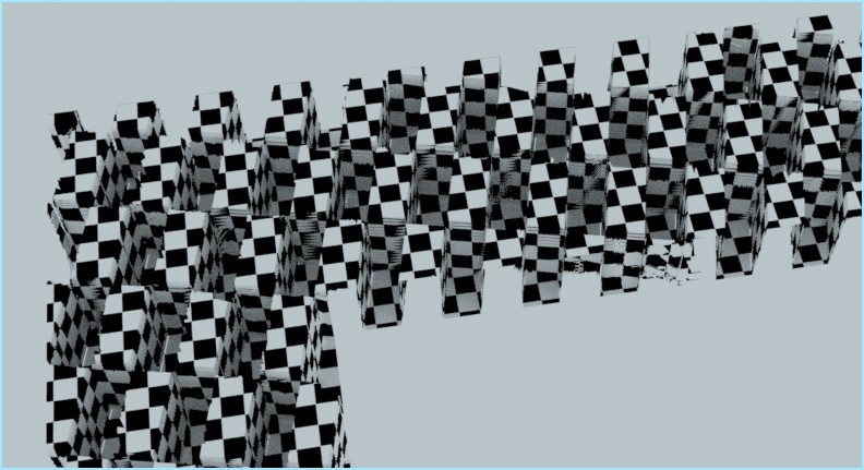

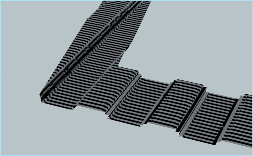

Displacement of procedural textures doesn't work as expected with baking texture node because baking not respect the same transform values and projection from main procedural node. Even if the same transform node is connected to baking texture node. It completely not follow the same direction and scale of main procedural texture.
tiles.zip
(185.09 KiB) Downloaded 175 times

SSmolak wrote:Displacement of procedural textures doesn't work as expected with baking texture node because baking not respect the same transform values and projection from main procedural node. Even if the same transform node is connected to baking texture node. It completely not follow the same direction and scale of main procedural texture.
I cannot see any unexpected results. There's not any problems on plugin level.
