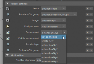

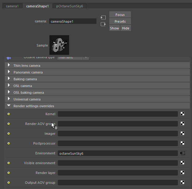

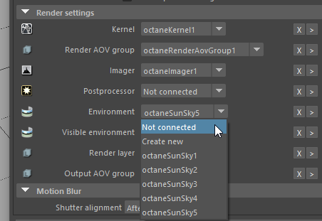

BK
Posts: 1515
johan_D wrote:Hi,
I'm not able to Install this version on Maya 2019
And on Maya 2020 I tryed a simple SunSky with a daylight environment, the sun make a strange red color
I tryed sun direction or daylight system with many diferent setings or hours, it's the same
anybody els saw that?
Hi Johan,
Thank you for the post!
Would you please share a screenshot of the error message with Maya 2019?
And, is it possible to share a video and the scene?
Please make sure you have selected the correct Environment node if your scene has more than one Environment node.
Also, check if you have attached any Environment node under Camera>Octane>Render Settings Overrides.
Cheers
Kind Regards
bk3d
