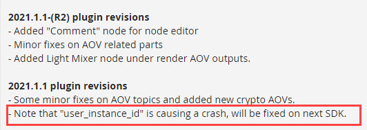

C4D R20 and Win10 (current) and I found a bug and did a lot of testing to pinpoint it (yay):
Enabling Cryptomatte "Instance" crashes 2021.1.1 and C4D while it is trying to save the EXR(octane):
I could provide a scene but it's really just a camera, a cube and a daylight object. No materials.
In 2021.1.R7 it works fine.
C4D 2025 | Win10
Posts: 16068
Location: Türkiye
zoppo wrote:.
zoppo
Posts: 305
Joined: Wed Dec 09, 2015 10:37 am
Location: München
aoktar wrote:
zoppo wrote:.
Well, that's one note I did not expect :´-D
So it is not a plugin problem and therefore not fixed in 2021.1.1-R2, and will be fixed in the next Octane version? I will wait. Thanks.

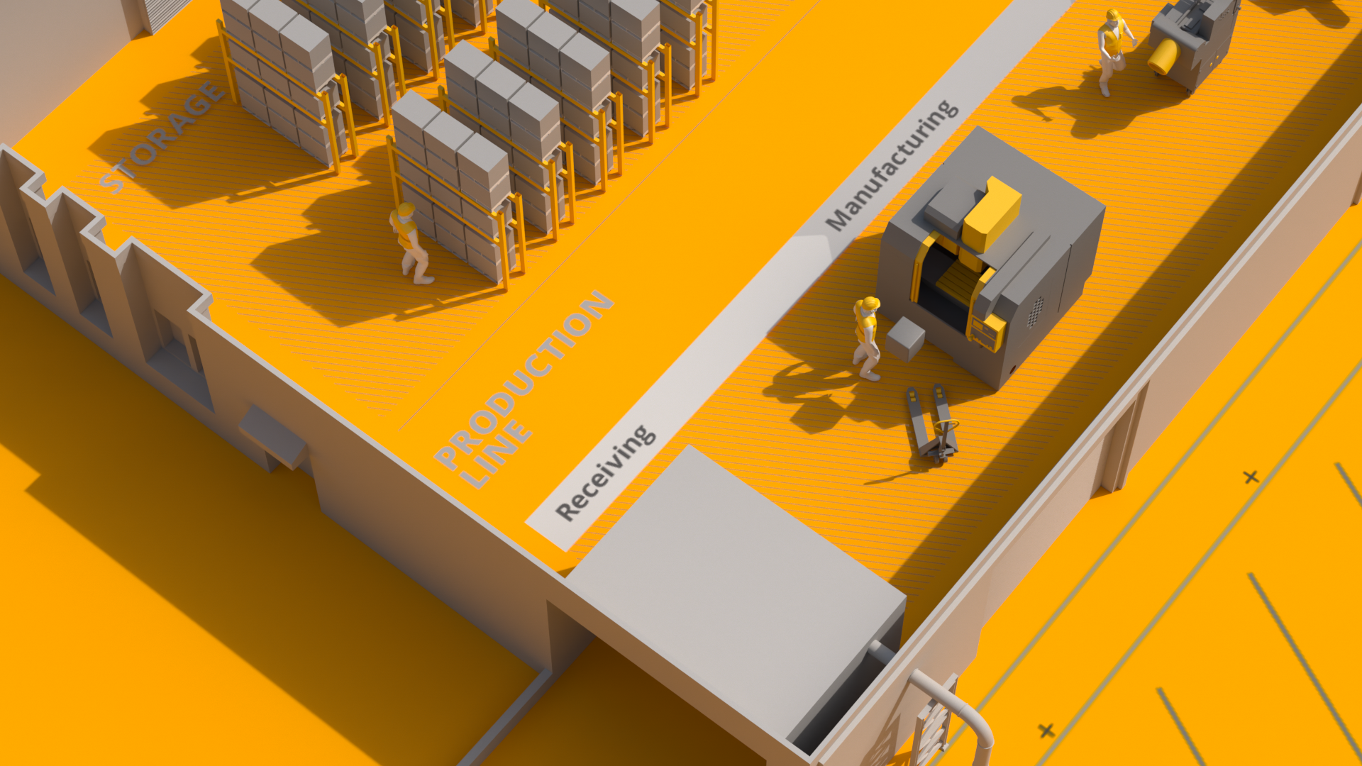

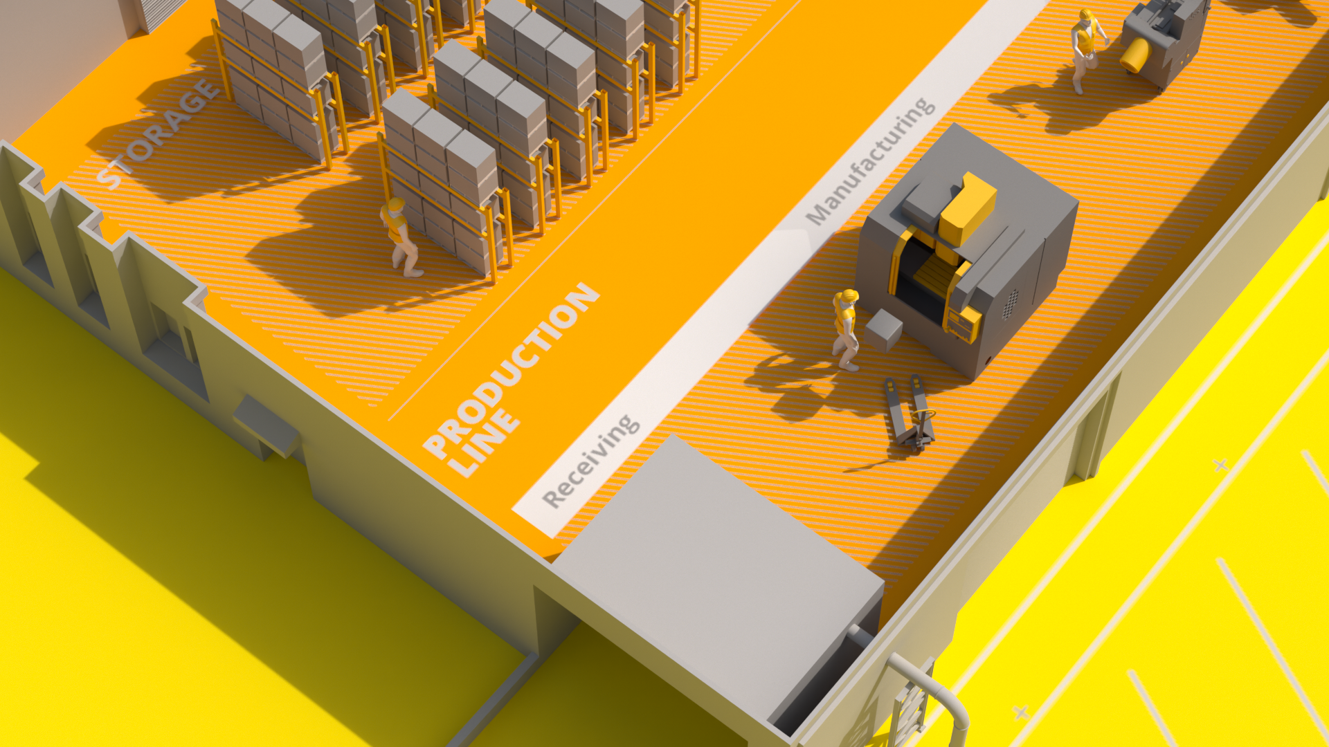

Hi there,
Switching from 2020.2 to 2021.1 I have noticed the way the materials and colors behave differently. Is it possible to revert back to old color behaviour from the settings? Changing the white light spectrum and use old color pipeline didn't do anything.
2020:
2021.1:
EDIT: Ok so I had to go back and change the color space options for each material from non-color data to sRGB or sRGB linear. Is there a way to retain these settings from old versions?
EDIT 2: For some reason on some scenes the textures are already set to linear sRGB and the render output is exactly the same as the old one.
