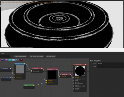

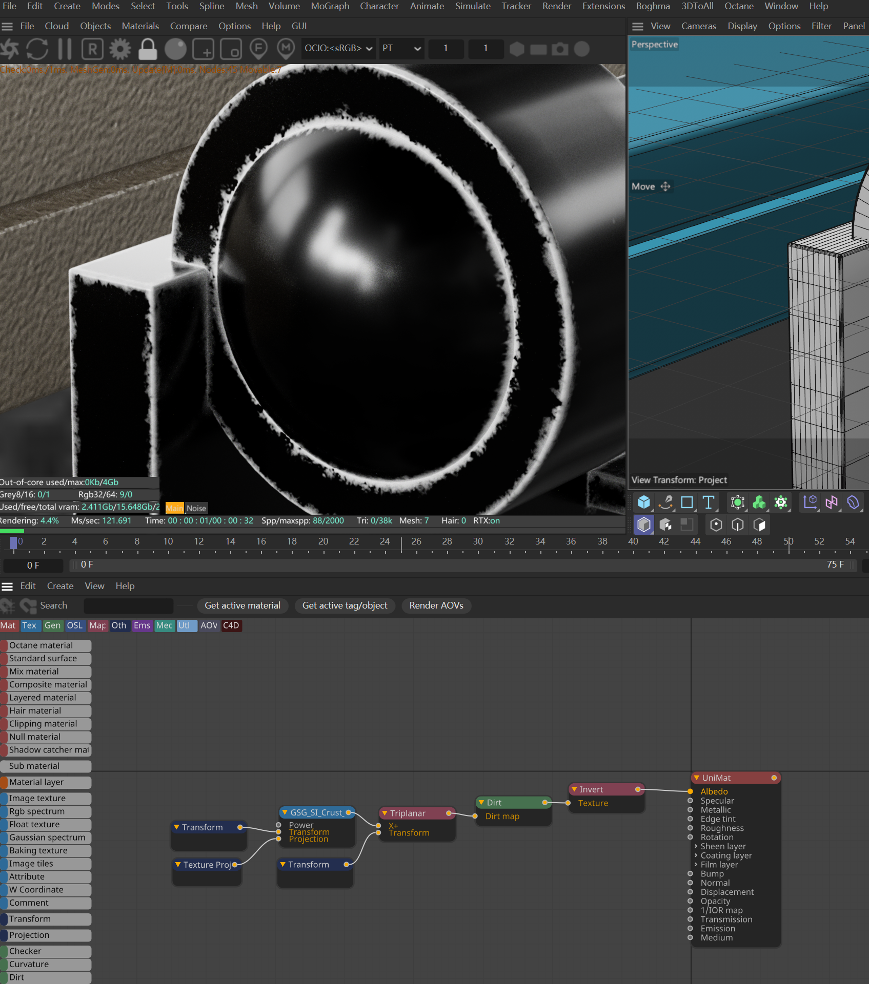

W_RTF wrote: I've seen replies, dirt and tex multiply and then connecting to bump is useful, but what I asked is that dirt connecting to bump is completely useless when there is a map as dirt map
I don't think it is clear exactly what it is you are trying to do. Can you post a simple example, such as the one I offered previously?
viewtopic.php?f=85&t=80831&p=422825&hil ... mp#p422825
W_RTF
Posts: 16
Joined: Mon Apr 20, 2020 1:57 am

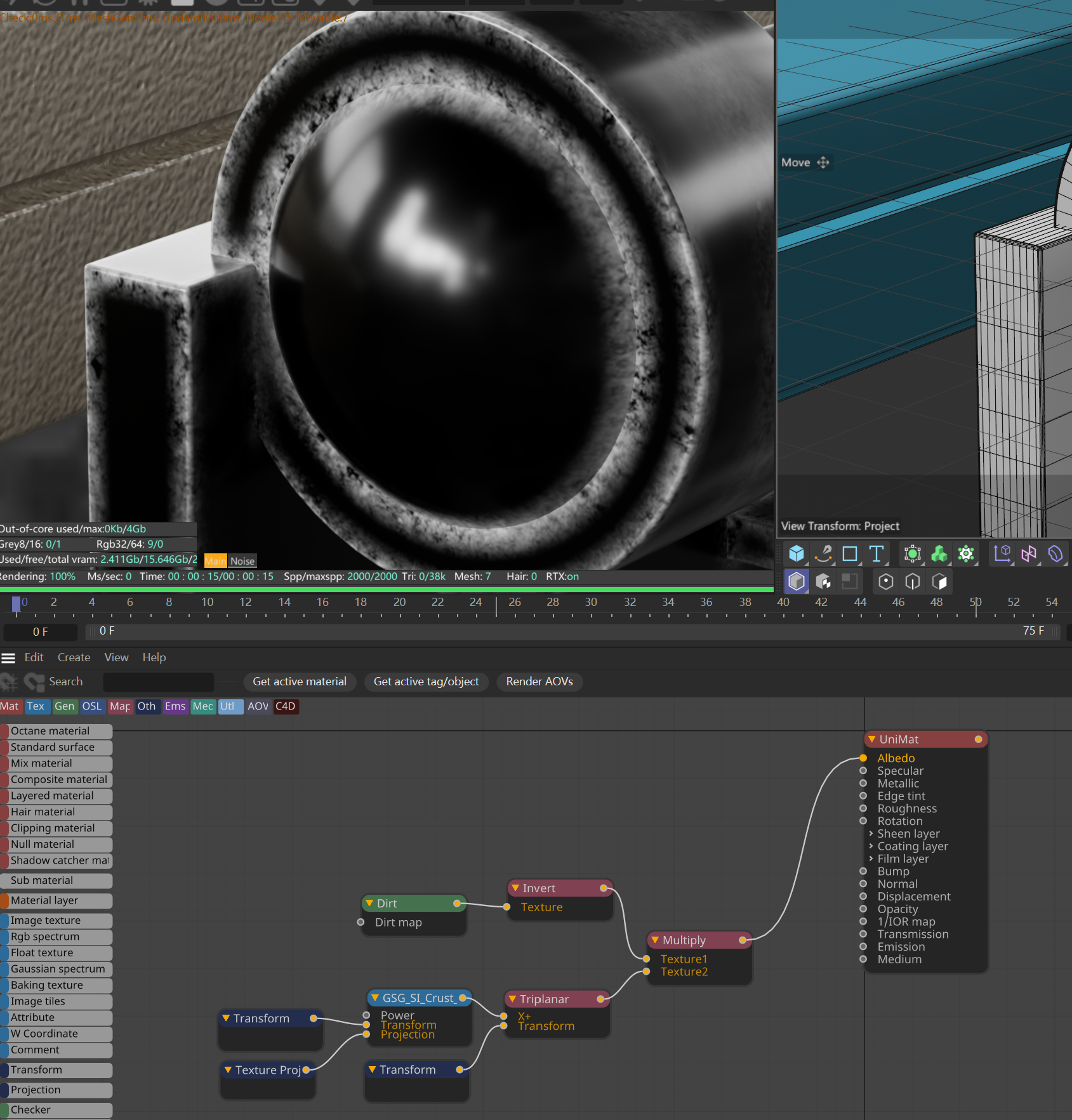

If I use a texture map as a dirt map, the edges will look more natural. If I multiply dirt with texture using your method, the edges will appear mechanical and very unattractive.

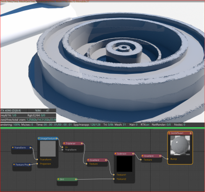

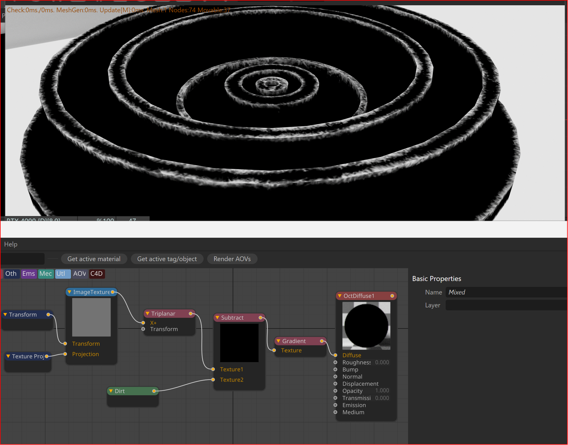

W_RTF wrote: If I use a texture map as a dirt map, the edges will look more natural. If I multiply dirt with texture using your method, the edges will appear mechanical and very unattractive.
You can use any blend mode that you like. Multiply may be too aggressive for the look you want. I usually put a Gradient or two in there for finer control of the drop off, also. Try Subtract for instance:
dirt plus grunge texture

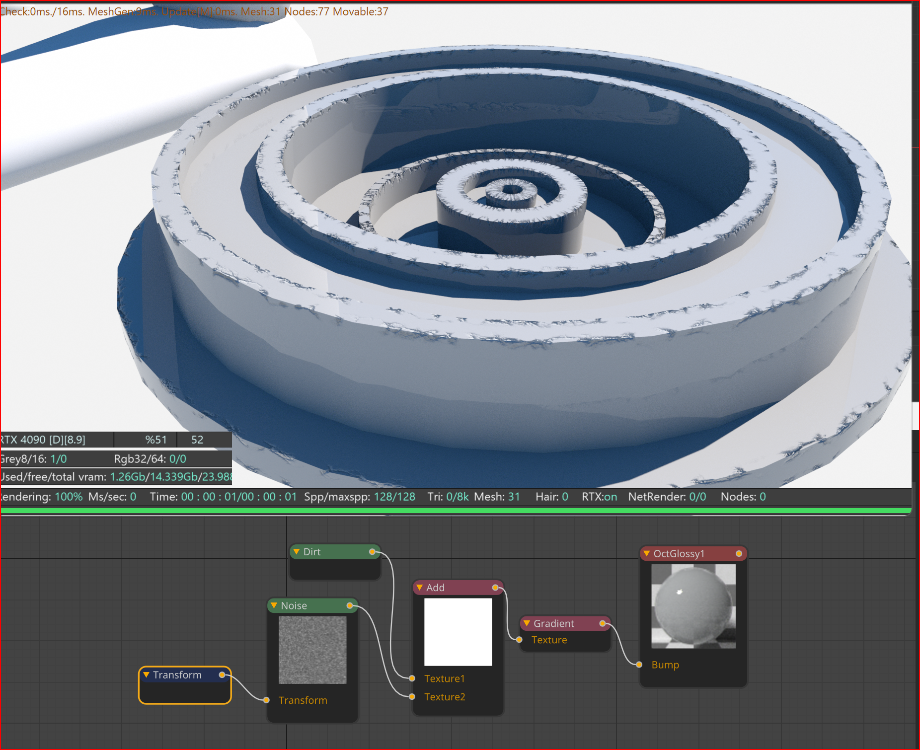

W_RTF wrote: Thank you for your answer. I think my problem is that dirt with texture doesn't work on bump channels
The origin of this thread was about Dirt not working with Bump, but it does with a little finesse. My response was that Bump doesn't like the raw data type output by Dirt, but once it is transformed by another node, it works fine. Here is the same material used only in the Bump channel.
Texture Minus Dirt in Bump
... and here's a version closer to the material shared in the original post:
Simpler Dirt plus Noise into Bump
