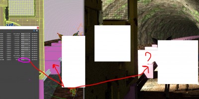

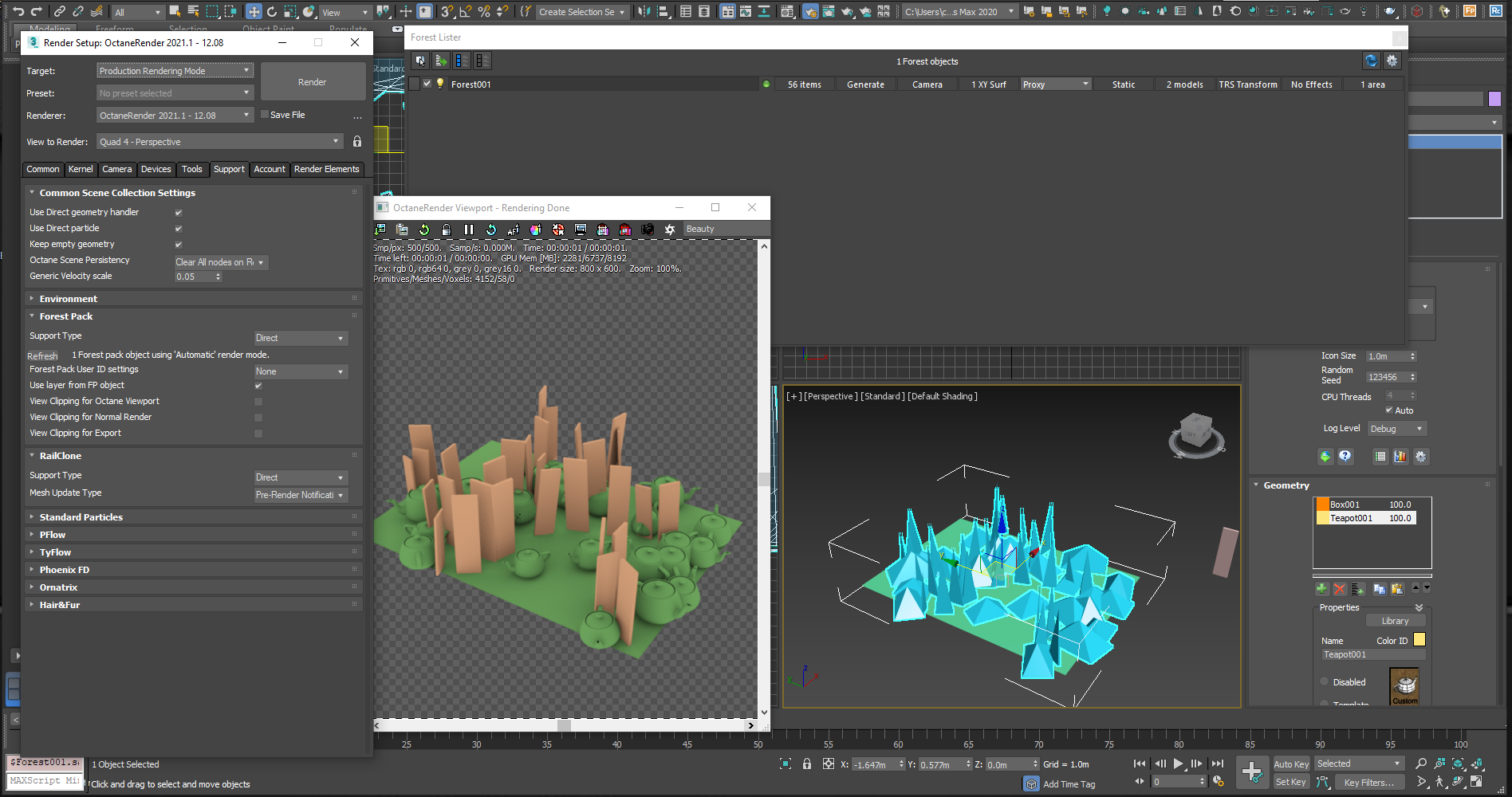

samsue wrote:this "problem" with RC very annoying... I have to keep switching between direct and standard
Hi samsue,
I'll have a look at the RC issue.
Could you send a small sample with different result between Direct and Standard modes?
idk maybe i am doing something wrong.
i have used this RC Objet for over 2 years but just now start this "problem"
neonZorglub
Posts: 1103
samsue wrote:
Hi samsue,
Hi samsue,
Thanks for the video.
I could reproduce a similar issue, but without a sample scene (max file), I can't be sure it's the same..
In my case, if I change the Pivot (in the Hierarchy panel) of the RailClone object, the Direct mode do not match the correct position.
As a work around, you could try to reset the pivot to the object center
This should be fixed in the next release.

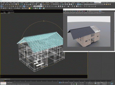

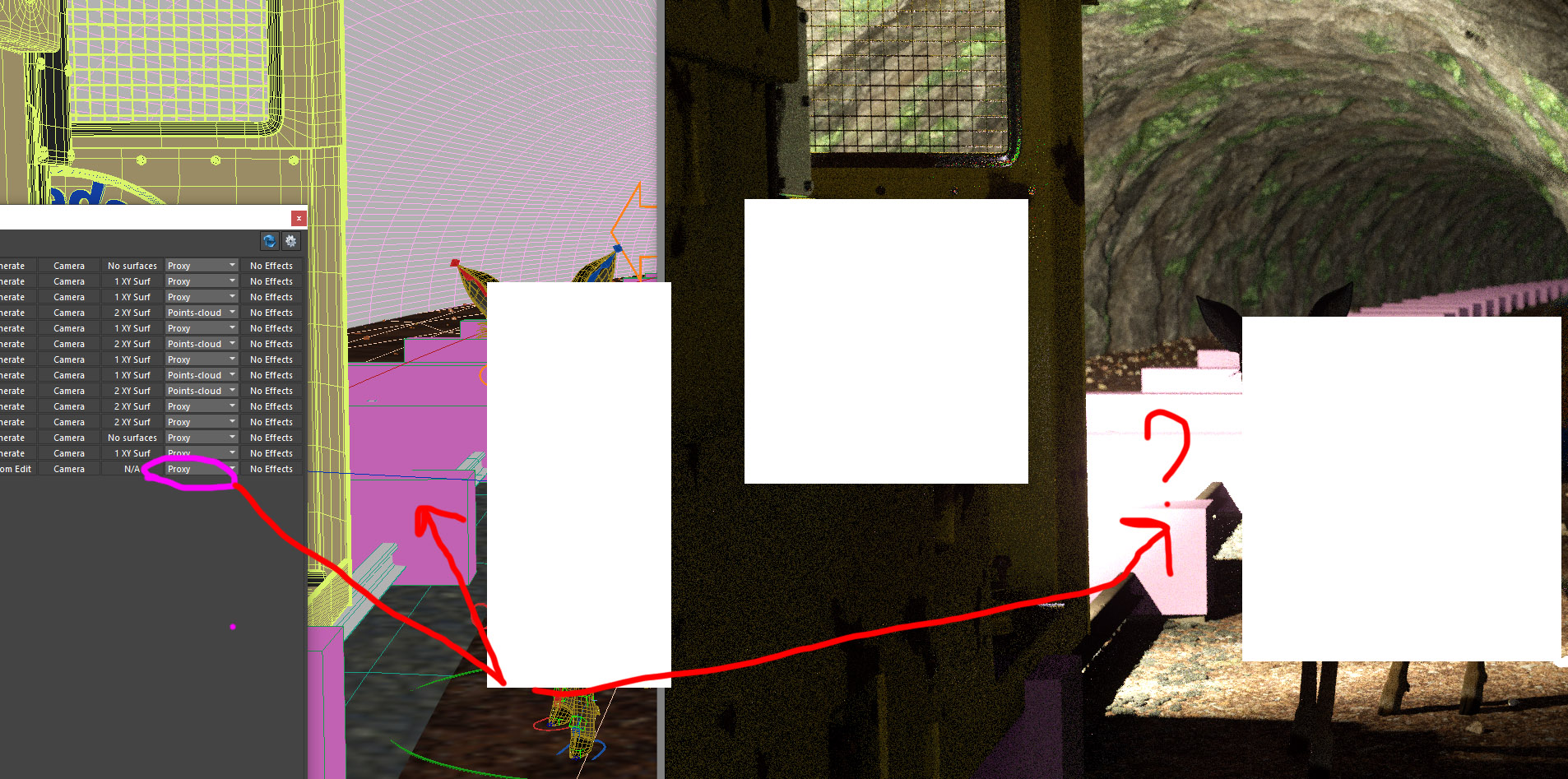

octane renders itoo proxy as actual proxy and not as a mesh
paride4331
Posts: 4005
coilbook wrote:octane renders itoo proxy as actual proxy and not as a mesh
Hi coilbook,
I'm not sure but I think Itoo manage meshes, not objects, so it gets the simple mesh from the octprx.
But only developers can fully answer this issue.
Regards.
Paride
neonZorglub
Posts: 1103
Hi coilbook,
Regards.
Paride

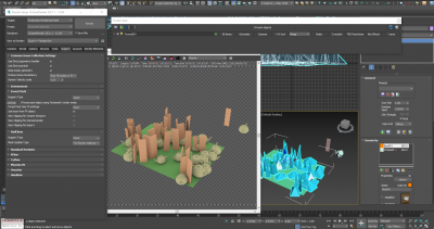

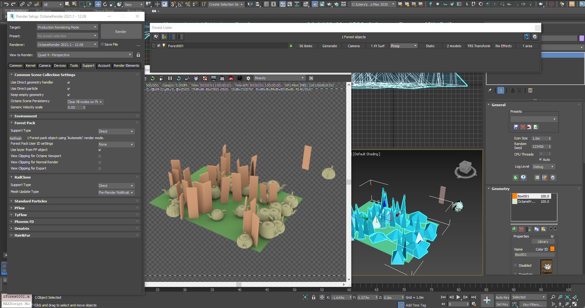

Hi coilbook,
It seems to work for me: (FP Pro 7.1.1)
FFP-simpleTest06_FpProxy.zip
(110.86 KiB) Downloaded 180 times
That's just setting Forest pack display mode to proxy.
But there was another problem, when trying to use Octane proxy objects (octprx files) as geometry for FP, FP gets the simplified mesh instead of the full mesh. but that doesn't seems to be like in your screenshot ..
This has been fixed, and you can you both octane proxy and FP proxy mode:
FFP-simpleTest09_OctProxy_and_FpProxy_OK.zip
(226.01 KiB) Downloaded 169 times
Could you share a sample scene ?

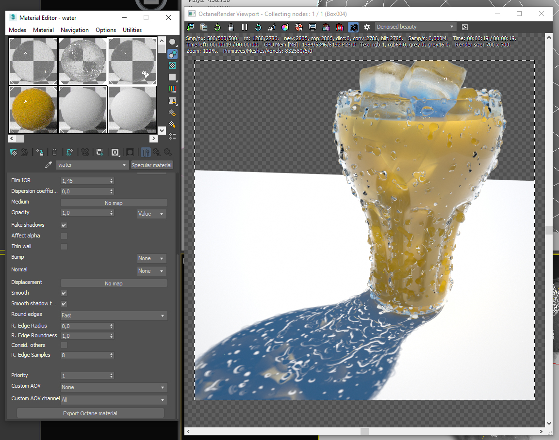

I wonder if the "Nested dialectrics" setting in Kernel type is working at the opposite : if unchecked, nested dialectrics works.
paride4331
Posts: 4005
HHbomb wrote:Hi,
Hi HHbomb,
If disabled, the surface IORr not tracked and surface properties are ignored.
Don't forget to set the material priority.
Regards
Paride
HHbomb
Posts: 1438
I mean, I think the checkbox is inverted
paride4331
Posts: 4005
HHbomb wrote:I mean, I think the checkbox is inverted
Hi HHbomb,
try by changing material priorities.
Regards
Paride

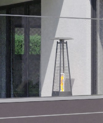

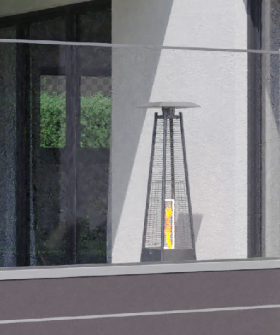

I noticed the opacity of my flame gets killed as soon as I move it behind the large glass (specular material).
