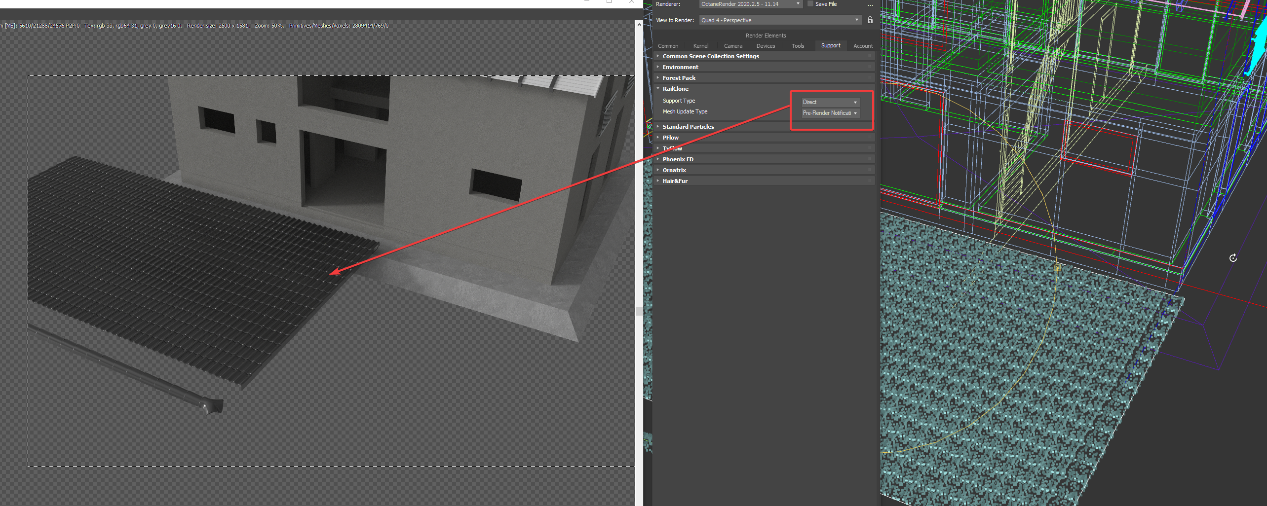

scene attached
Thanks for your scene.
That's strange.. It works fine on my machine..
