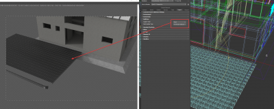

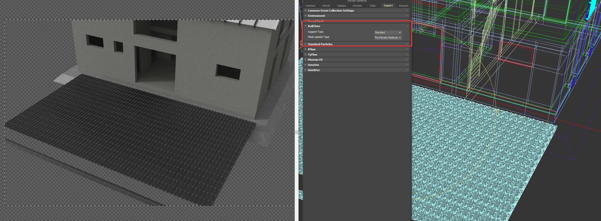

@NZ : I will make some test as you ask.
But for now, 2020.2.5 11.11 works fine. In 2020.2.5 11.12, u did something that slow down with textures or materials. If I remove all materials of the scene, it works fine even with lastest build.
- TroubleShooting / Enable Repeated Viewport Update = IS OFF
- Material / Enable Animated material update in Viewport = IS OFF
ANY hint to use OctanePreset helper ?

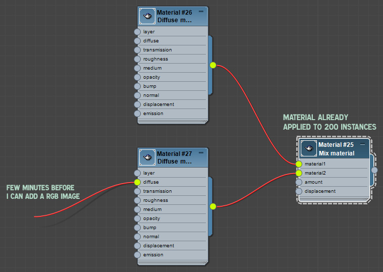

HHbomb wrote:@NZ : I will make some test as you ask.
Hi HHbomb,
I updated the page about the Preset Helper:
viewtopic.php?f=27&t=76178#p405061
I re-tested with 200 boxes and the slate editor, but I couldn't see much performance issues..
I hope I can find something if you add a Preset helper..
Thank you
