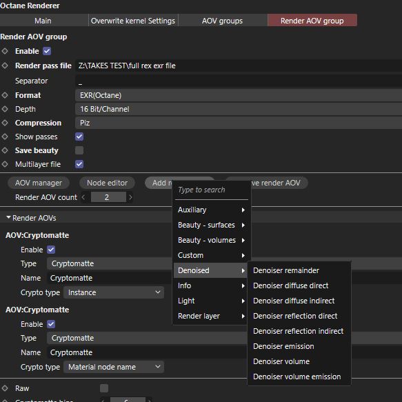

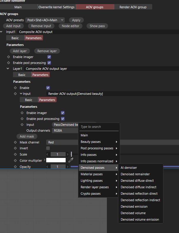

Can someone tell me how to get a Denoised Beauty pass using the Render AOV Render option? AI denoiser does not seem to be available as an option like it is through the add composite inputs on the AOV groups tab (see pics). And the Save Beauty option always gives a noisy version, even if the option is to use Denoised beauty is checked on the Main page.
This is the problem, if I use the first option, it gives me the Denoised beauty but also adds the Denoised Remainder to the exr and makes each file 5mb bigger than it needs to be. Thanks.
It's correct to do this what you selected. Be sure denoising activated in camera imager. "AI denoiser" is a typo, "Denoised beauty" is correct word.BCres wrote:Can someone tell me how to get a Denoised Beauty pass using the Render AOV Render option? AI denoiser does not seem to be available as an option like it is through the add composite inputs on the AOV groups tab (see pics). And the Save Beauty option always gives a noisy version, even if the option is to use Denoised beauty is checked on the Main page.
Thank you, Aoktar. Yes, denoise is checked in the camera imager and I am getting the correct outputs for the cryptomattes and the denoised beauty.
I'm just also getting a "Denoised Remainder" layer as part of the .exr file that I don't need and was wondering if there's a way to get rid of that and just get the Denoised beauty and the two cryptomattes.
Anyhow, it's not a huge deal and I can work with it. Thank you for confirming that I'm approaching it correctly.
