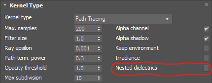

Elvissuperstar007 wrote:BUG
where does this projection come from? uwi map box
That comes from the Nested dielectric settings that is enabled by default, when loading an old scene..
It should be disabled in this case.
It will be disabled by default for old scenes, in next release.

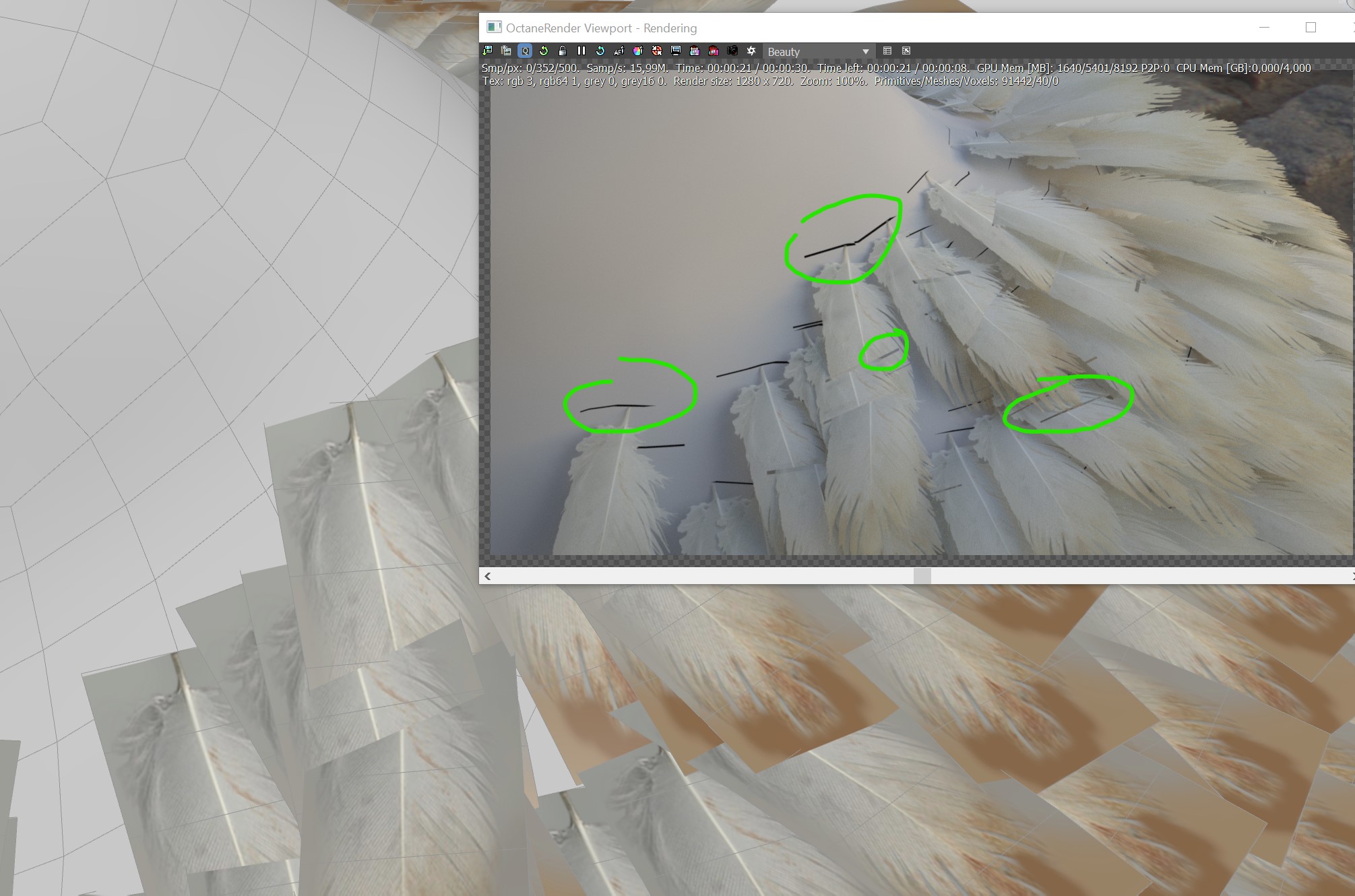

I post this here too..just in case:
i think it's a bug... with opacity/alpha map.. i am doing feathers mapped into planes..
even if the alpha map is not touching the edges.. this happen the same..
would you check?
regards!

javierluisbravo wrote:I post this here too..just in case:
would you check?
regards!
Hi javierluisbravo,
could you share your issued scene (in pm if you want)?
3dsMax > file > archive.
Regards
Paride
