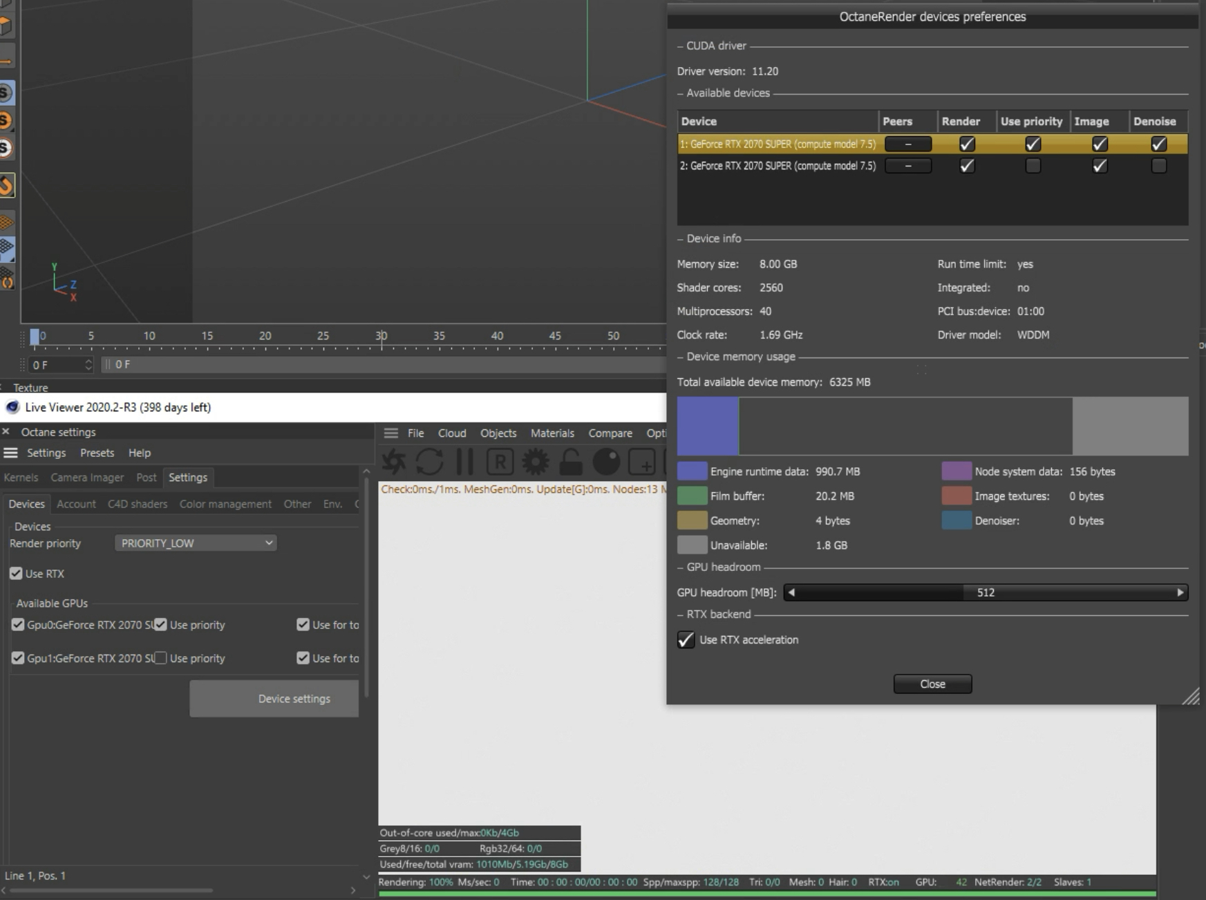

Ok, here's some more interesting findings:
This is the Vram situation when rendering an empty scene. Please note the engine runtime, geometry and unavailable ram usage:

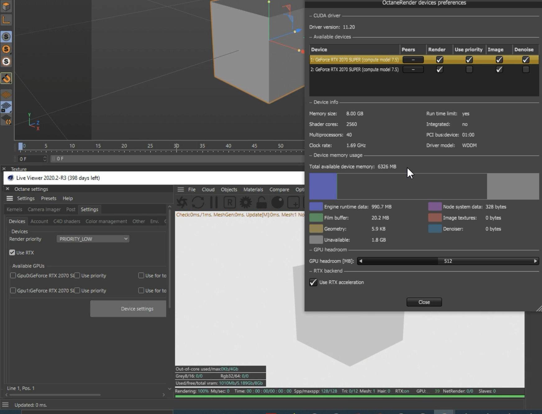

This is the vram after adding a default cube to the scene and rendering:
The only difference between the two scenes is the geometry which went from 4 bytes to 5.9kb. The weird thing is the unavailable vram shot up from 1.1gb to 1.9gb. I cant wrap my head around this. Is Octane using some additional vram here and showing it as unavailable? Is windows upping its vram reserve just because im rendering a cube instead of an empty scene? No idea what's going on here.

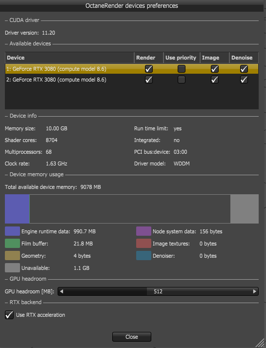

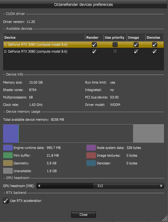

interesting, but please consider that it follows the Total available device memory, and in your case, there is a difference of ~800MB, so, 1.1 + 0.8 = 1.9.
I have done the same experiment here, and the difference between an empty scene, and a simple cube is only 1MB:
Empty scene

Simple cube
Simple cube
ciao Beppe

Hi Beppe, thanks for your reply.
What im trying to understand is how come you get 100mb difference while I get 800mb?
Between the empty scene and cube i dont run any other software that grabs vram and this test is quite repeatable.
Really confusing.
