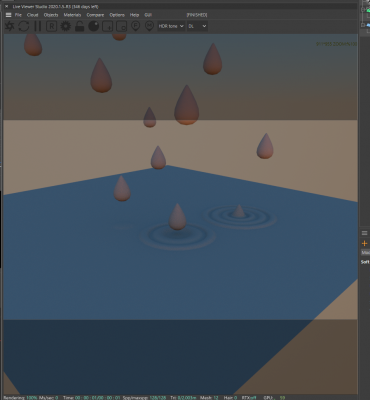

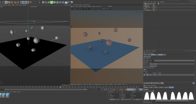

Emitter + Displacement with Field Falloff set to Emitter.pinarer wrote:@lanklaf yes i did that for a still image but I am trying to do for an animation, and not just one ripple in the middle, I used emitter like that in that video, drops are falling down and each time they fall down I would like to have the ripples in an animation
Then modify the Falloff spline:
P.S. works in motion.
+ Make your spline to look like this:
For a more natural Falloff.

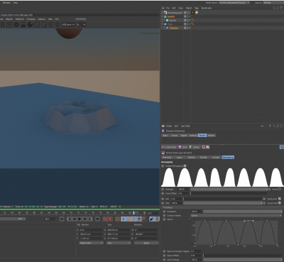

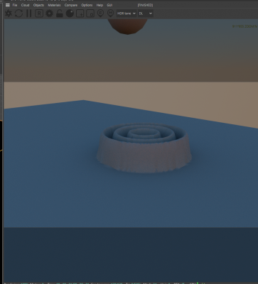

You don't have any displacement because you should plug in some color or gradient into displacement shader in shading tab, for example simple white colorpinarer wrote:@lanklaf , i dont know where am i doing wrong , but mine doesnt look like yours. I am horrible doing the splines, I never done before so i tried my best for a first timebut there is no effect on the surface
+ increase plane polygons to 500x500,
It's 10x10 by default.

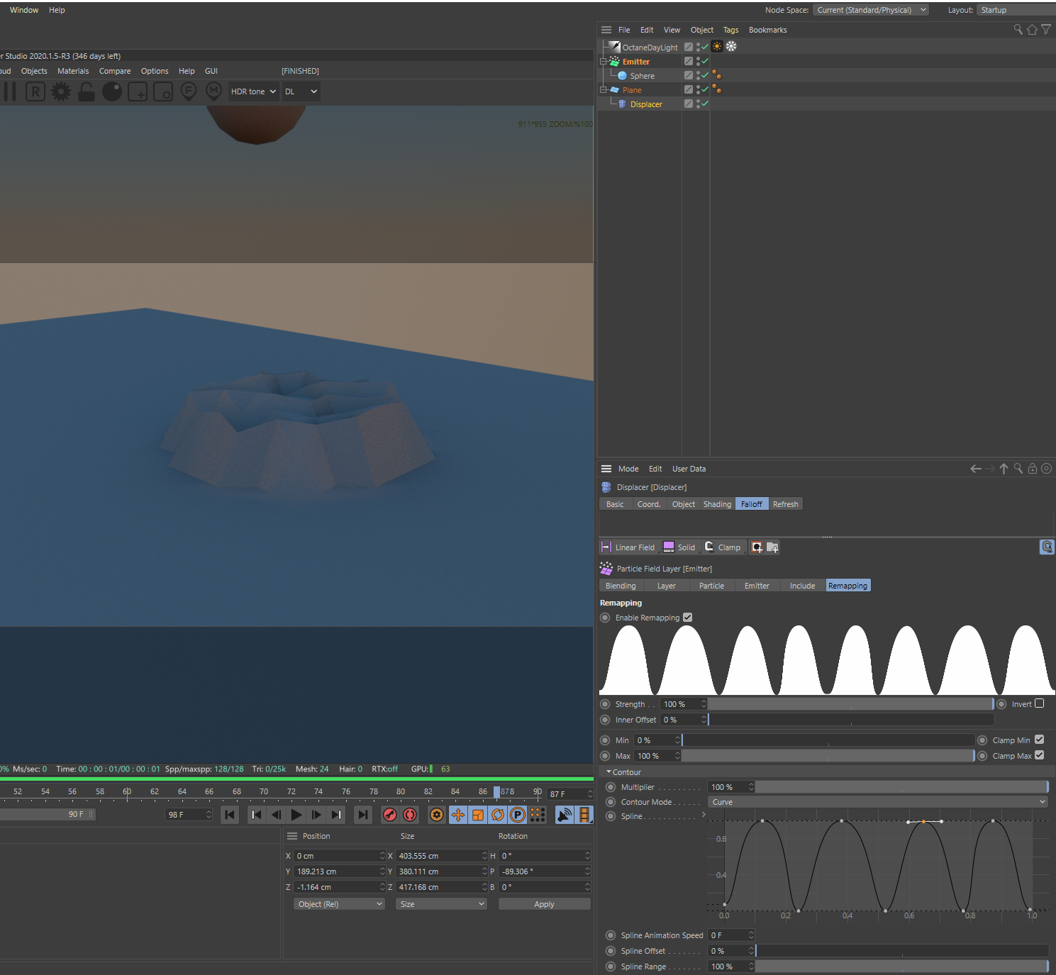

You can select spline preset under the spline editor. Select something that looks like flipped "U". Than, select all the spline dots, right click and select "double", than do it again.pinarer wrote:@lanklaf.. yes i am almost there : ))) thank you! I see now some shapes now but how you did yours that nicely ripple look? how did you adjust that look?
Also make displacement hight much lower, around 1 cm.
