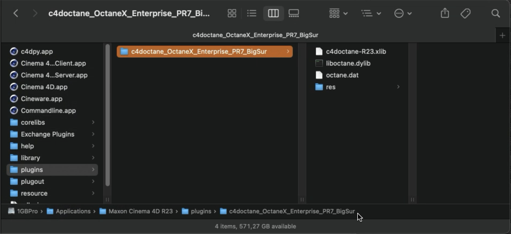

It seems a bad installation to me :roll:
Please share a screenshot like this one, that shows both the c4doctane directory opened, and the entire installation path, thanks:
ciao Beppe

Actually it looks like I had managed to install it in two different C4D plugin folders. Oops! They should streamline that :lol:
Having it in Cinema's bundle /Applications/Maxon Cinema 4D R2X/plugins and in Cinema's other plugins folder ~/Library/Preferences/Maxon/Maxon Cinema 4D R2X/plugins.
Not totally certain how it happened, but it is good to see its a me problem. Keep up the good work on Octane X!

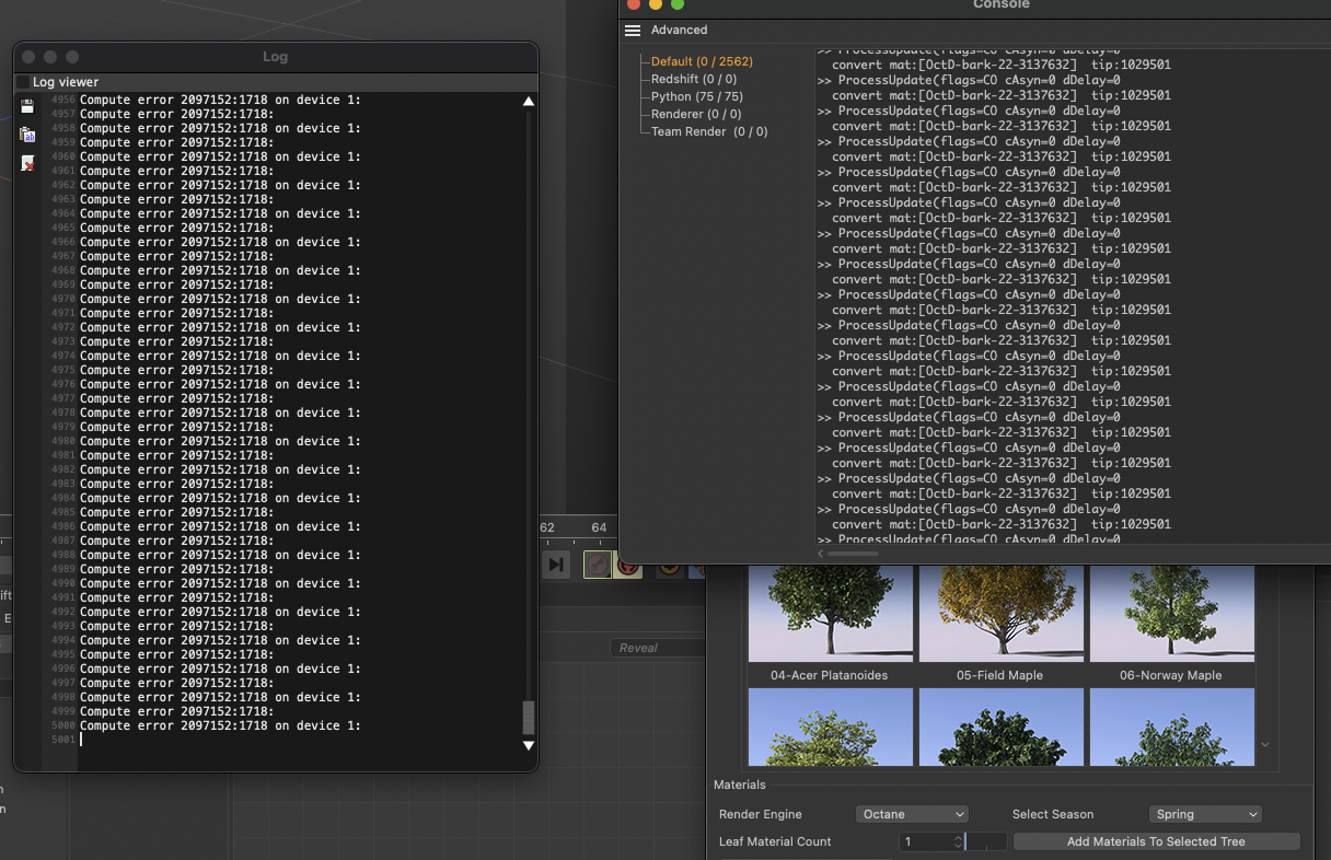

also.. getting material issues:

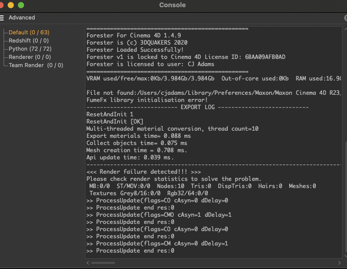

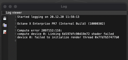

Anyone else on PR7 with macos 11.01 - notice that trying to download anything from LiveDB is instant beachball of C4d?
Very odd.

cjadams wrote:
Very odd.
Have you deleted unused plugin dll after extract?
Posts: 10489
cjadams wrote:
Very odd.
Please upgrade to Big Sur 11.1 stable to have the latest apple Metal driver, or this version cannot work.
