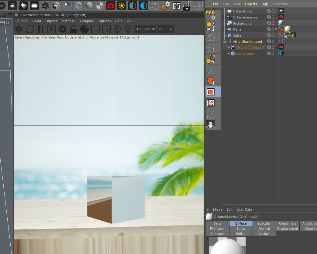

This screen shot attached hopefully is better for getting across what Im trying to achieve. So its quite basic which is why im sure octane should able to handle it? All I want to do is be able to have the the box or an object look like its sitting on the table top so it casts a shadow and the table top reflects back into the cube, is that possible with octane?

Ok ive played around and got to this simple setup now showing the shadows on the table top. To do this though ive had to use the diffuse material which enables me to have the shadow catcher turned on. My next question would be how to go about being able to use a glossy floor so the object reflects on the floor image? Also if I want to be able to use a separate HDRi can I do that too?
Ive attached this file now.
Thank you again for any help.

Sorry to insist, but for Reflections you need to use the Render Layer technique:
http://www.aoktar.com/octane/RenderLayer.html
Shadow Catcher option is only for shadows, we don’t have a Reflection Catcher material.

Do you know how I could go about making that floor texture look like its reflecting the objects and be a part of that scene? I know if I just put a plane with a glossy material on it then it'll reflect the objects but then it wont look correct. Is there anyway to project my background table texture so that it would be in the same position but just reflect? Would I have to use some sort of reflection pass and comp it together?
Posts: 10611
have a look at what is going to arrive with the upcoming 2020.2-XB4 c4doctane version. This is an example of Compositing in Standalone viewport of the Render Layer technique, where you can define the intensity of the reflection layer, or change its color, in real time, with the desired image in background:
