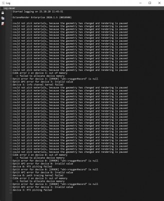

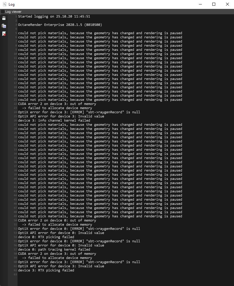

Just an update, opening up older projects that I know with 100% certainty I never got this memory issue....I am now getting a memory issue (see screenshot below for log)
1GB VRAM is free. Im trying to work out what to roll back to as this never used to happen (same machine)
Thanks for any assistance! :)
