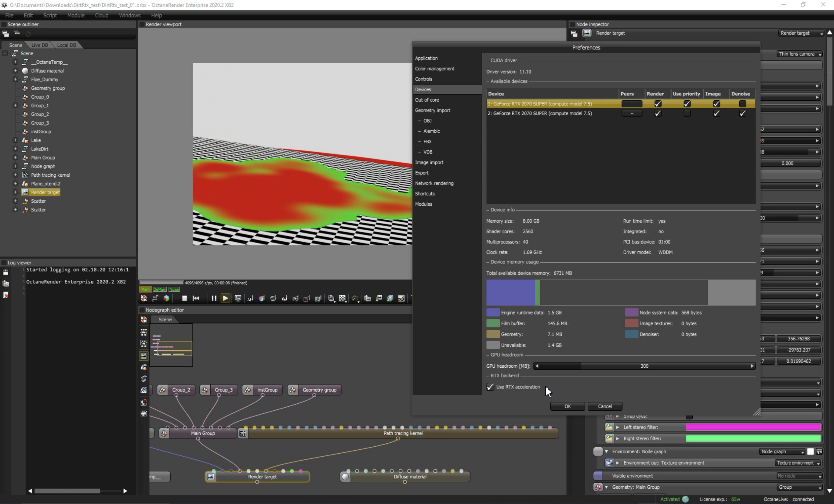

Since both of you have mixed RXT/GTX GPUs, I think that this is causing the issues you are seeing.
I only have RTX GPUs on this machine, and if I import the pxlntwrk‘s material, everything works as expected:
Note that you could need to reload the scene after enabling RTX.
@19Nik90: please try to render with RTX GPU active only, and RTX option enabled.

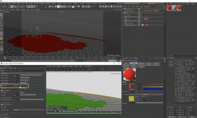

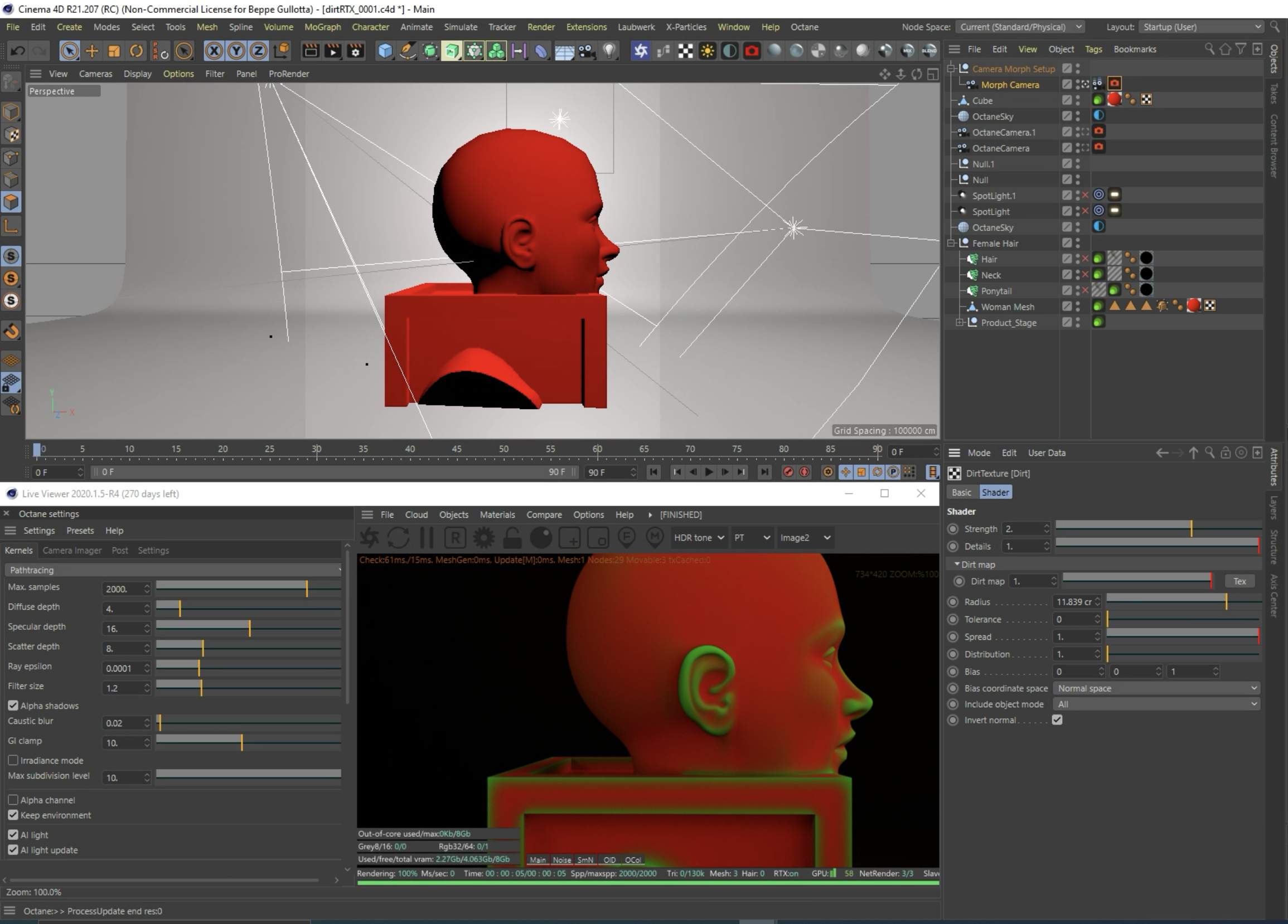

@pxlntwrk: I have another issue with your scene, the result is constant, but the Dirt effect is weak, if RTX option is enabled:

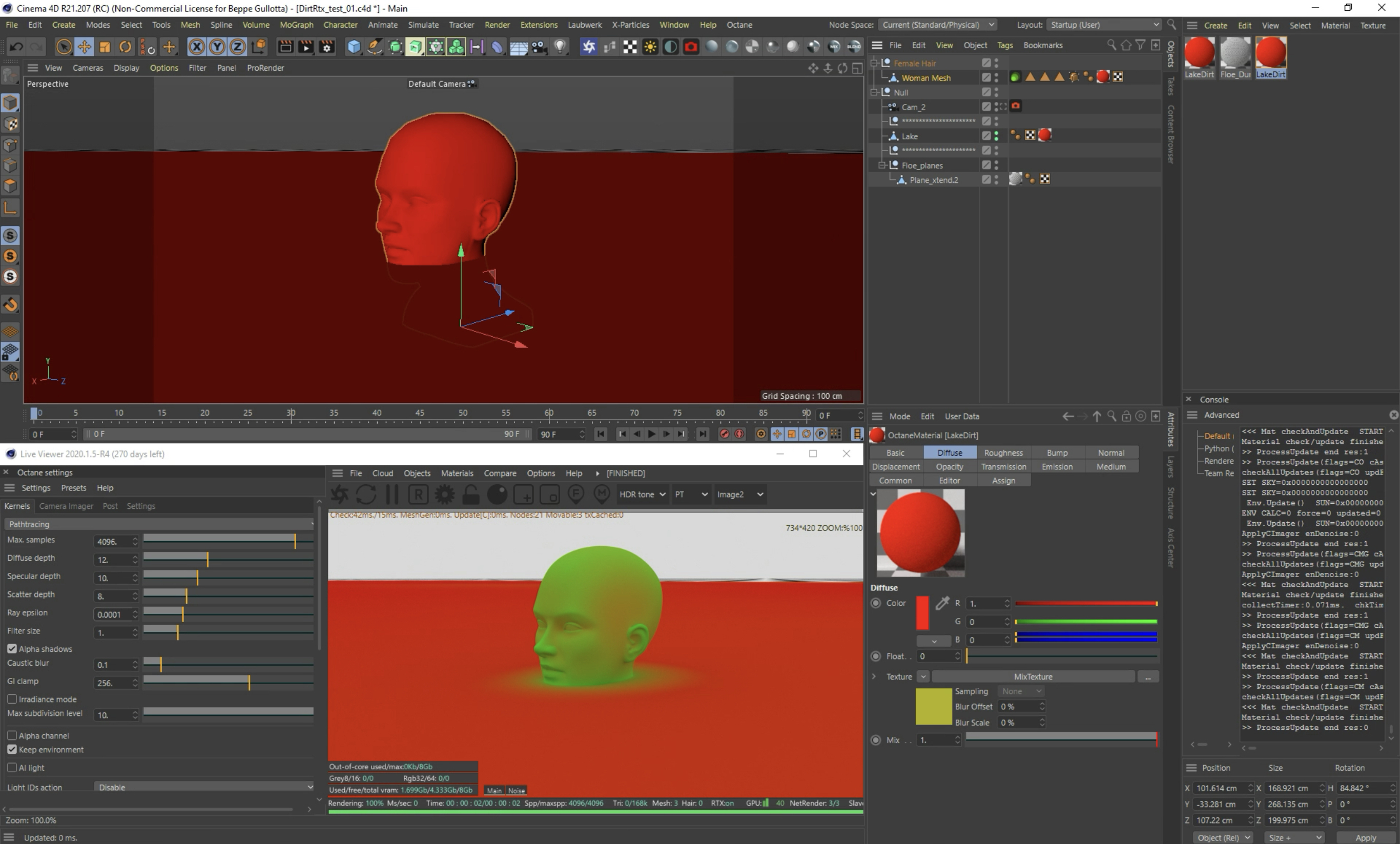

I have noticed that the geometry is particularly big, so I have imported a mesh in cm, and it is working as expected, so it seems that the big scale is causing an issue with Dirt, if RTX is enabled:

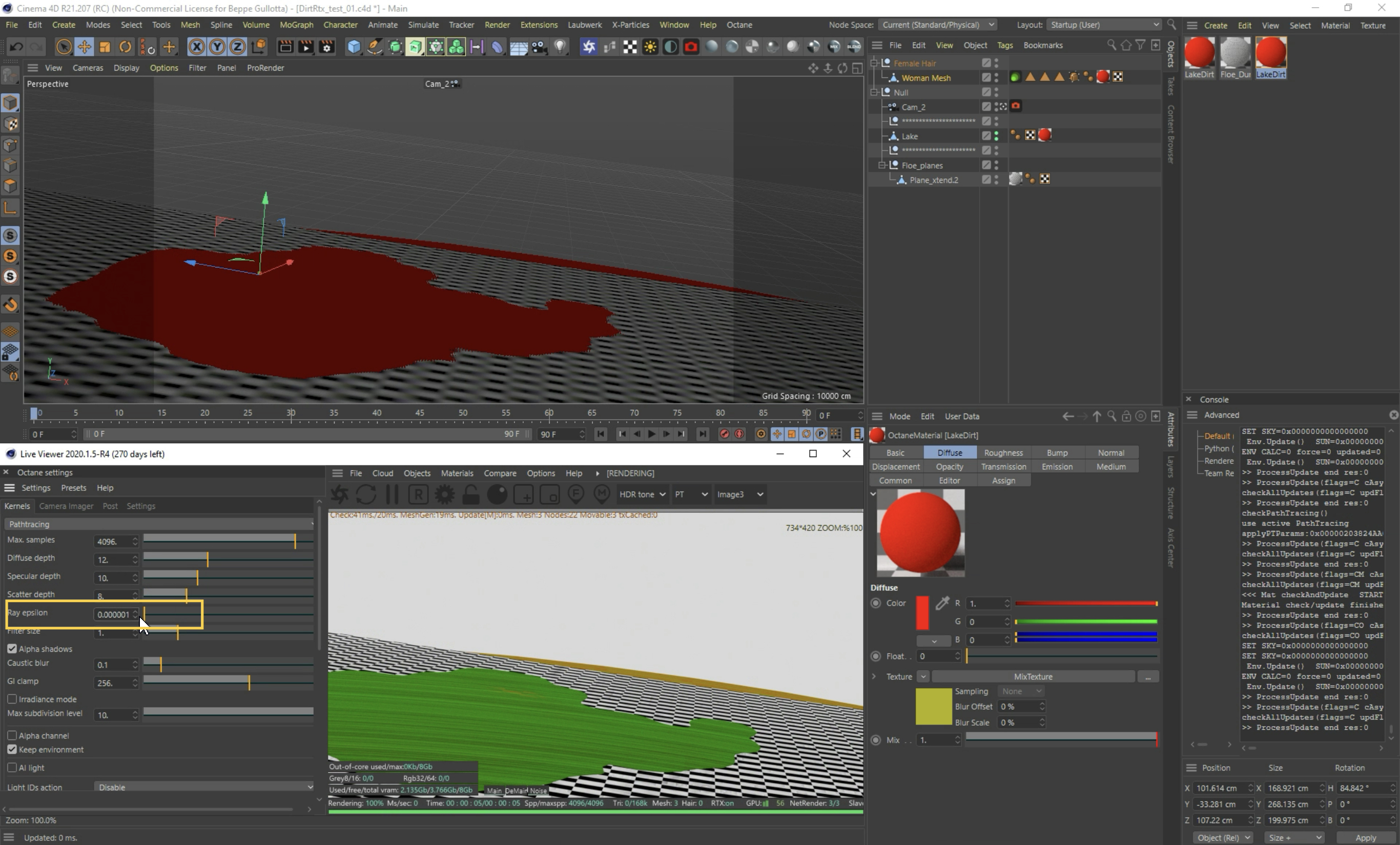

If you decrease the Ray epsilon value, you can see the green coming in, but obviously the effect is ruined:

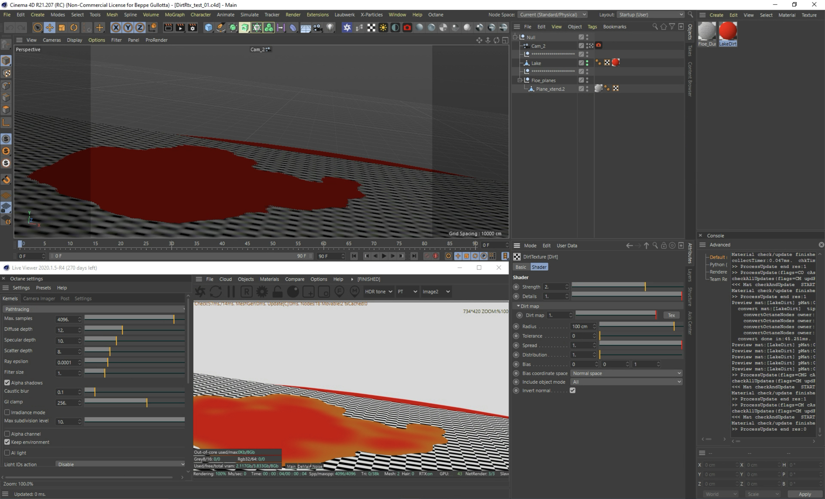

The good news is that the issue with Scale in Dirt + RTX is already solved in 2020.2-XB2:
Do you mind to export to Standalone 2020.2-XB2 in orbx format, to check if also the issue with mixed RTX+GTX is already solved?

Rendering only with the 2080ti and RTX ON the problem does not occur.
It's like you said, the mix with RTX GPU and not creates the problem.

I tested in both versions of Standalone, and the problem occurs well in version 2020-1.5 and no longer exists in version 2020-2XB2.
