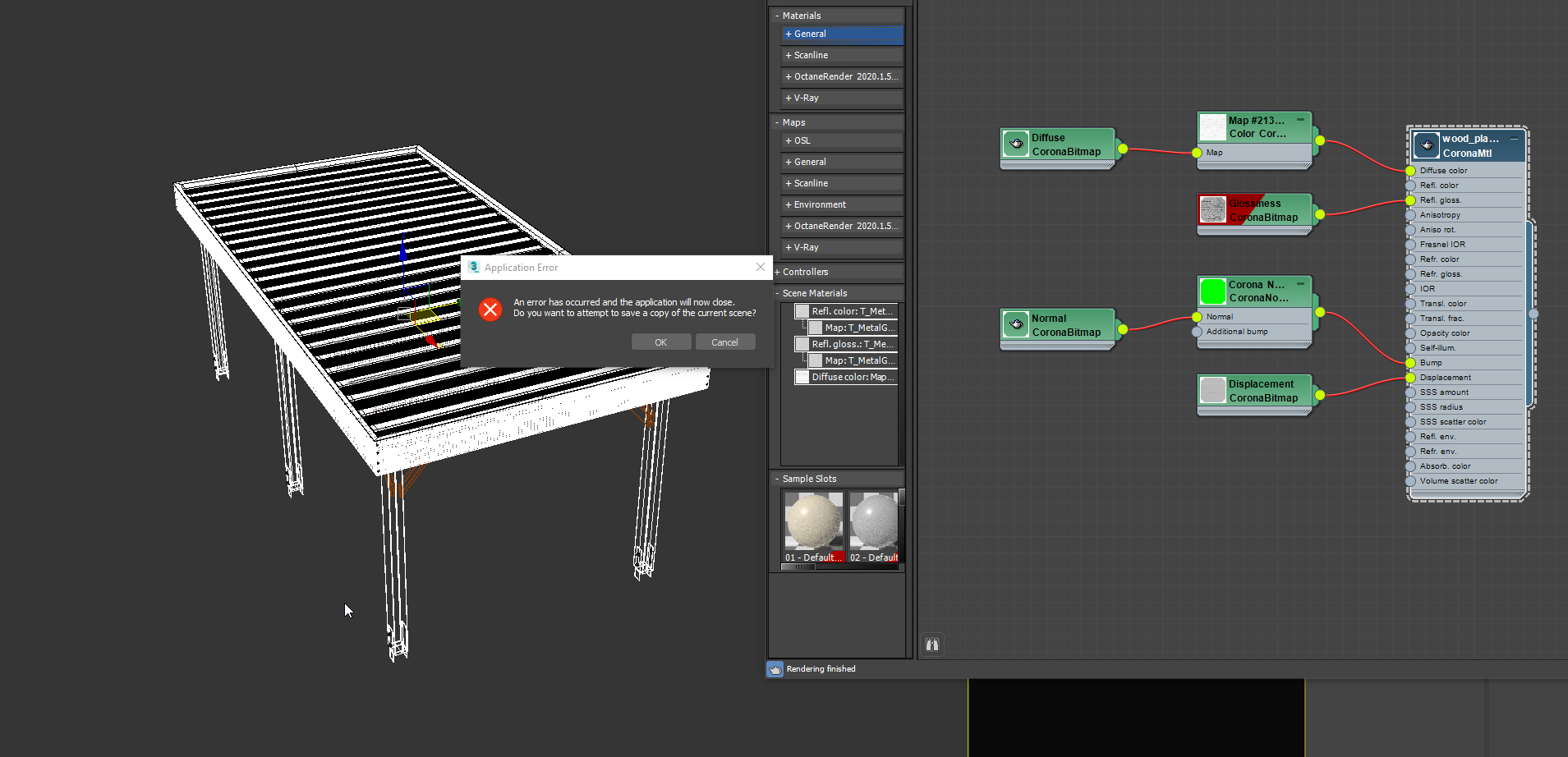

if I activate the on-the-fly material converter my scene closes when I try to render, rendering the separate models I have no problem, only with the rest of the scene, idk if has any kind of relationship with the out-of-core, the object you can download attached.
garagem_back.rar
(6.95 MiB) Downloaded 246 times
paride4331
Posts: 3989
Hi samsue,
I had not crashes with Corona material converter on-the-fly, but you have not attached the textures and hdri, so my testing your file cannot quite convincing to me.
Could you share the whole scene (in pm if you want)?
3dsMax> File> archive
Regards
Paride
