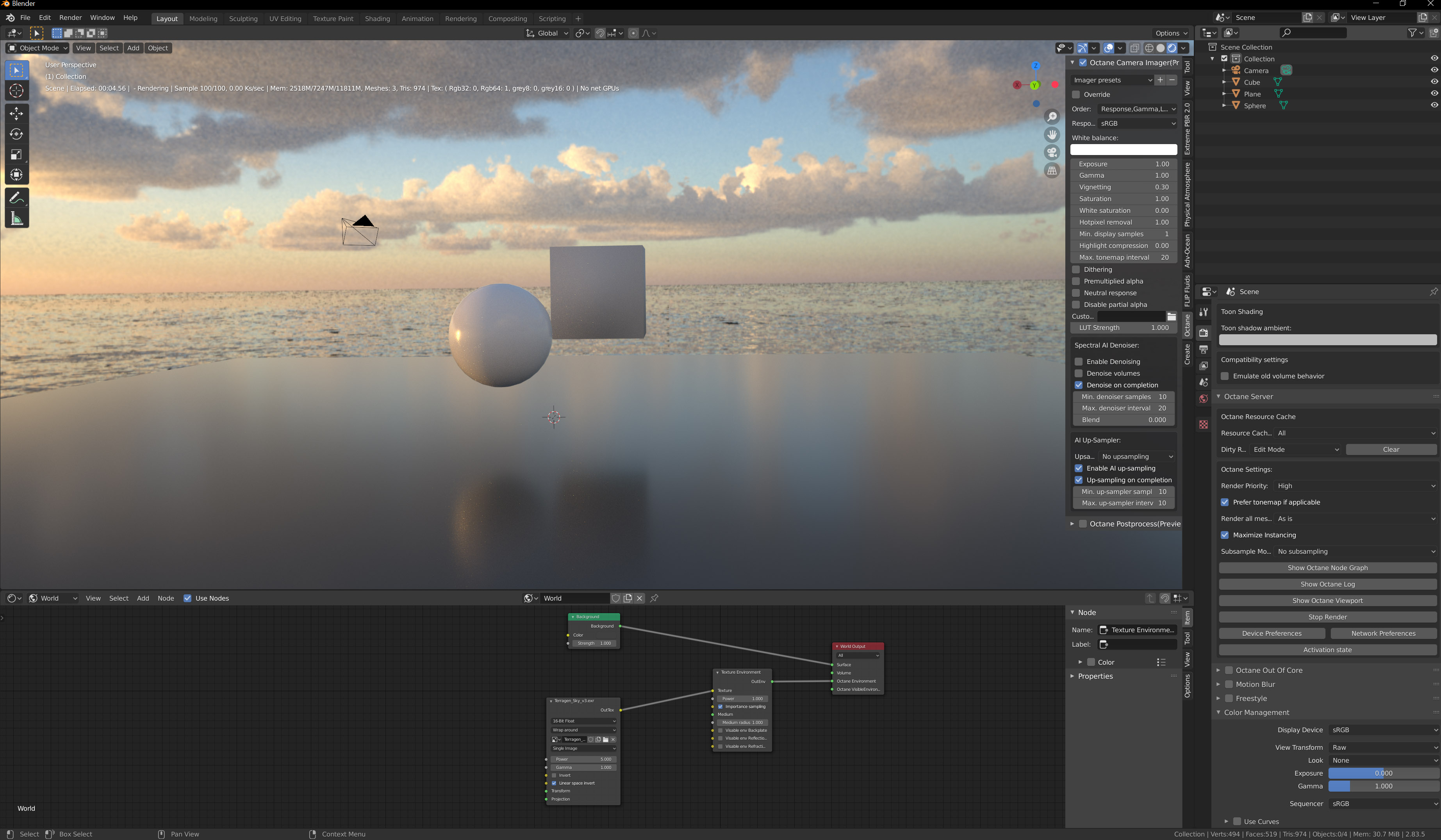

back to your example: i got the sky looking good but i dont have the direct sunlight and casted shadows as you do. as grimm suggested i can use my exr as a skybox in the daylight system and have sun that way, but i dont understand how you made your setup. you have the same texture env setup as i (attached image) but a different look.

My setup is very similar to the one in your original scene. I just fixed the color space related issues and the HDRI gamma (you can see the options for the environment in the videos I linked).back to your example: i got the sky looking good but i dont have the direct sunlight and casted shadows as you do. as grimm suggested i can use my exr as a skybox in the daylight system and have sun that way, but i dont understand how you made your setup. you have the same texture env setup as i (attached image) but a different look.

i have done an exact same setup as yours with the hdr and have gotten different results, and have provided a screenshot with the relevant values and parameters all visible.
