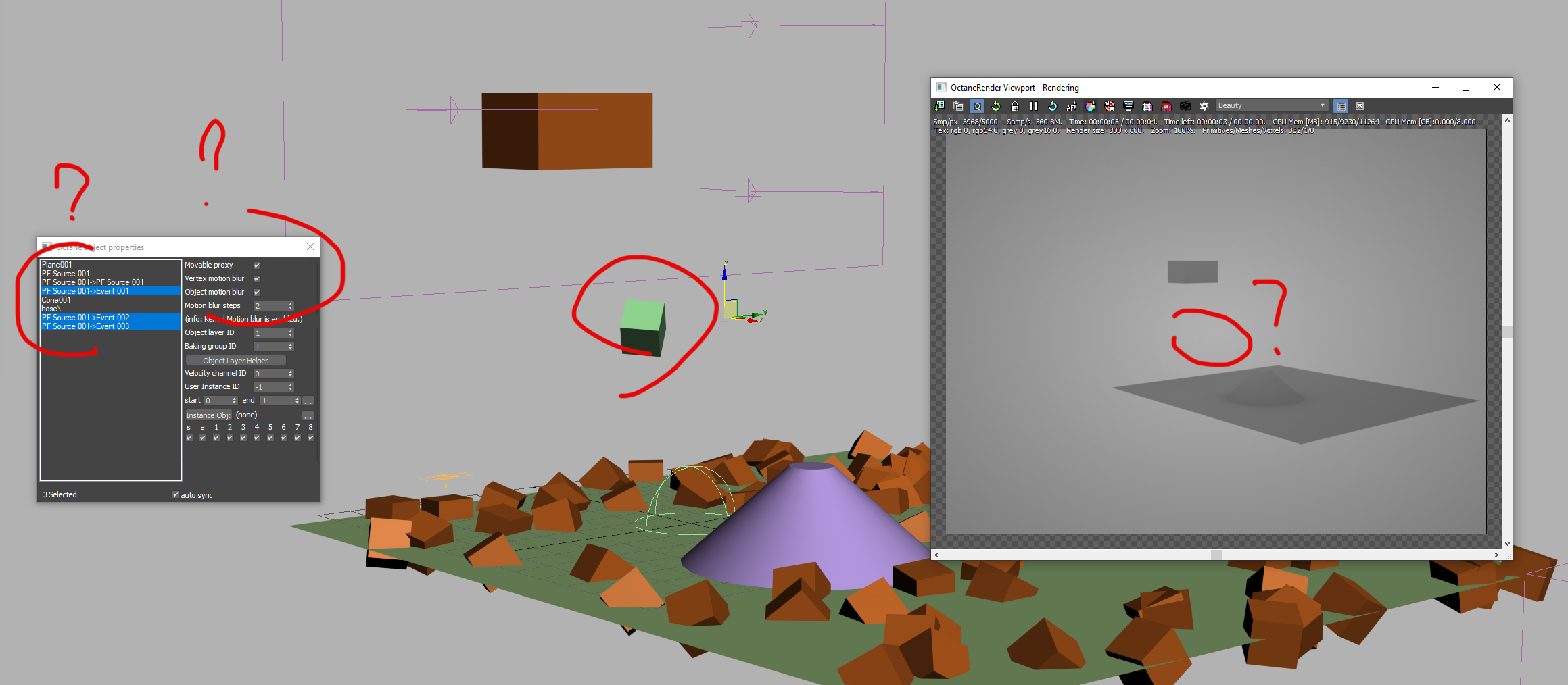

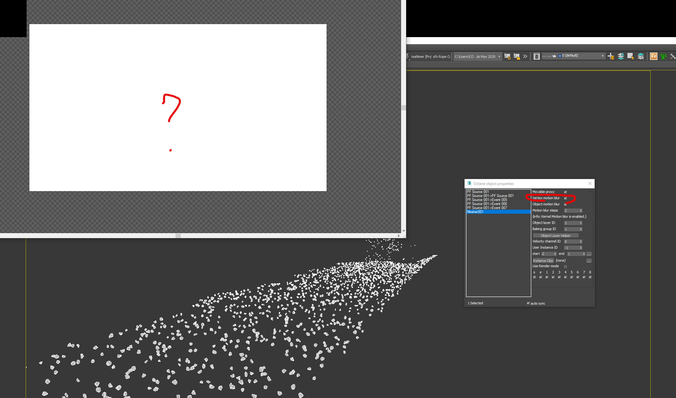

I attached pflow motion blur scene bug. Can you look at it? Why when I enable MB particles disappear? Am I doing anything wrong. Maybe not right events I choose for mb? Can you use 2019.1.5 version Thanks
I want to add even using MESHER (viewtopic.php?f=81&t=55639) and enabling object mb does nothing. Enabling vertex mb makes mesher diappear Please try 2019.1.5. 8.23
pflow mb bug.zip
(49.73 KiB) Downloaded 213 times

coilbook wrote:HI PAride,
Hi coilbook,
you forgot to attach the issued scene.
Regards
Paride

Hi Paride,
it is. Right between two images above as zip file

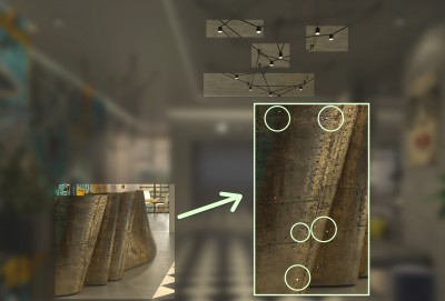

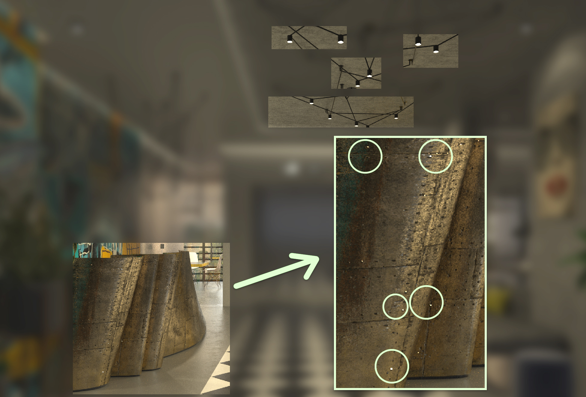

im having another issue that i had before...but not for a while (maybe related of the lighting im using and a particular material)
in metallic material- mixed with some diffuse material for details. im having some intense fireflies and cant seem to shake them with with caustic blur at .95 and GI clamp at 16 - not fancy of going lower.
Using hotpixel removal doesnt help with these either.
using pathtracing and they lurk there way over the 5000 samples.
the lights that might be causing this (if it isnt a bug) are Black body emission with an IES (i didnt use IES in Black body emissions lights before and now this give me much lesser noise leveles)
intense fireflies
intense fireflies
Hi coilbook,
did you try setting "legacy" in Pflow support?
Regards
Paride
Hi coilbook,
Regards
Paride
Thank you it works. It was set as discard.
