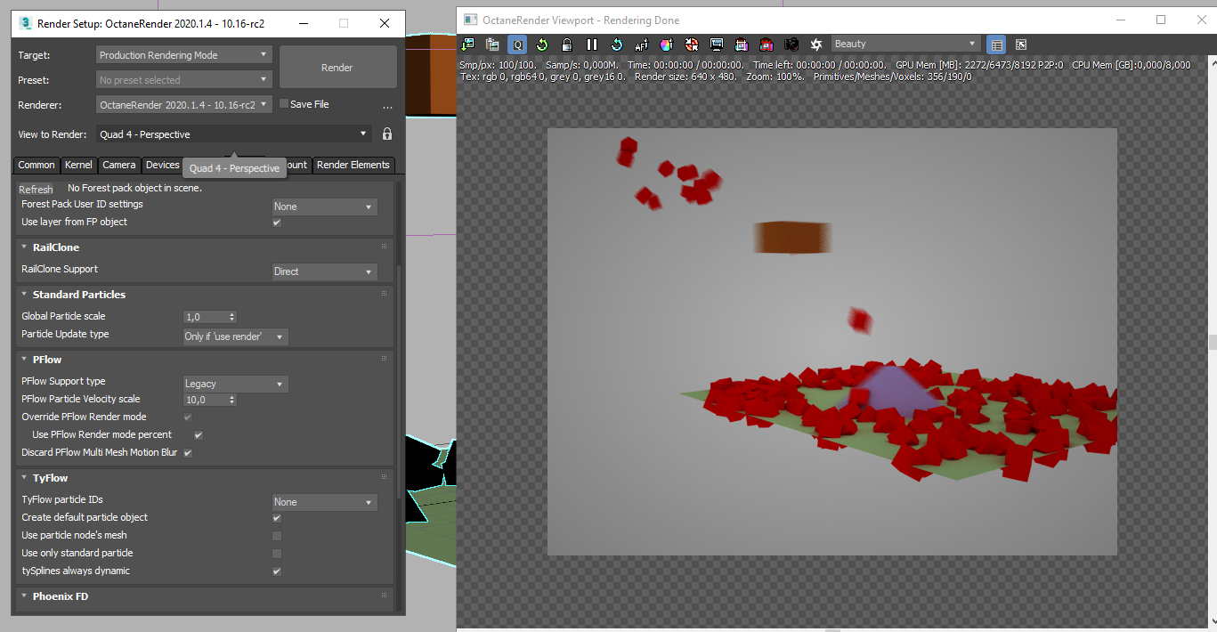

I attached pflow motion blur scene bug. Can you look at it? Why when I enable MB particles disappear? Am I doing anything wrong. Maybe not right events I choose for mb? Can you use 2019.1.5 version Thanks
I want to add even using MESHER (viewtopic.php?f=81&t=55639) and enabling object mb does nothing. Enabling vertex mb makes mesher diappear Please try 2019.1.5. 8.23
pflow mb bug.zip
(49.73 KiB) Downloaded 170 times

coilbook wrote:HI PAride,
Hi coilbook,
you forgot to attach the issued scene.
Hi coilbook,
did you try setting "legacy" in Pflow support?
Hi coilbook,
Regards
Paride
Thank you it works. It was set as discard.
