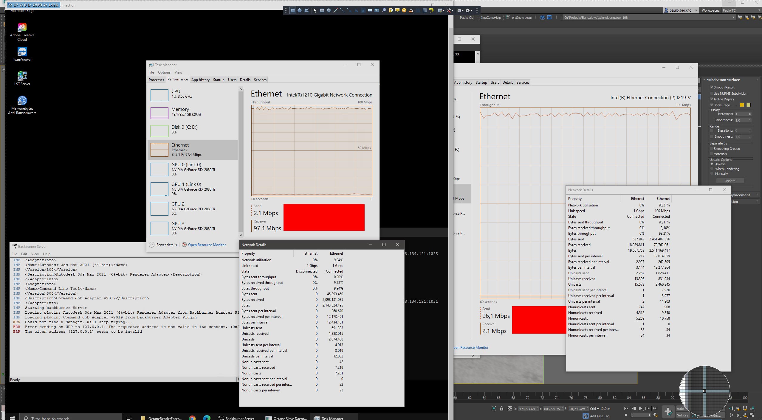

stays like this for more than 10 minutes
samsue
Posts: 393
what do these values mean?
my scene has only 600mb its nots possible that takes more than 10 minutes to start rendering

seems to be the same problem, very slow network.
But I wanted to understand why exactly.

have you tried a new cat cable from master to slave?
Look for my old posts I had similar problems.
This is one of them viewtopic.php?f=81&t=66727
I think switching to windows 10 solved it. It's been a long time ago. Try turning off webroot off if you have it.

I happened to see that on one of my video cards on the render server the fan was not working ( each card has 2 ) sio i removed this card from the server.
During the day I noticed that the server was starting to render much faster and the cuda erros are gone and on top of that, I installed a 10gb network card on my workstation.
I assume that because of overheating something has broken on the video card, despite the temperature according to MSI afterburn, was always the same as the others.
