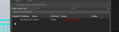

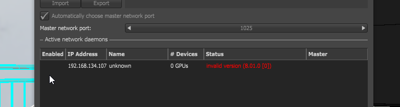

Hi, we need another slave build?

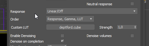

Would it be possible for you to choose a folder and thus exchange between different Luts more easily? Like the Response menu?
would be so cool

samsue wrote:Hi, we need another slave build?
Hi samsue,
you would install Octane slave node 2020.1.3 (8010300).
Regards
Paride

samsue
Posts: 393
Hi samsue,
Regards
Paride
yes, i have OctaneRender Enterprise 2020.1 (8010000)
stop works after update to 2020.1.3 - 10.12 from 10.11

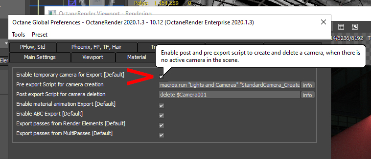

Hi! I cant complete the orbx export ! I receive a message ( Failed to create camera with m_PreExportNoCameraScript )
last version plugin and max 2021

paride4331
Posts: 3997
Tharso wrote:Hi! I cant complete the orbx export ! I receive a message ( Failed to create camera with m_PreExportNoCameraScript )
Hi Tharso,
With no Octane camera, did you check "enable temporary camera for export" option in Octane Global preference panel?
Regards
Paride
