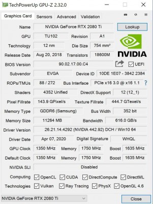

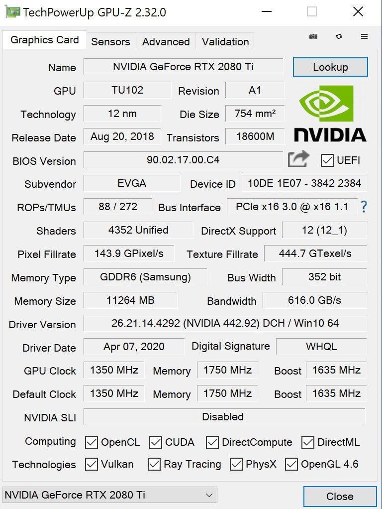

Same crashes here, with a 4* 2080ti rig.
I was experiencing such crashes in the past, but the old 431.86 studio driver solved them. But now, the crashes are back...
edit : please find a pdf with gpuZ reports for each card : https://documentcloud.adobe.com/link/re ... 1947f393f4

Posts: 10487
Please remove the DCH driver with DDU, then perform a clean installation of standard Studio 442.19 driver:

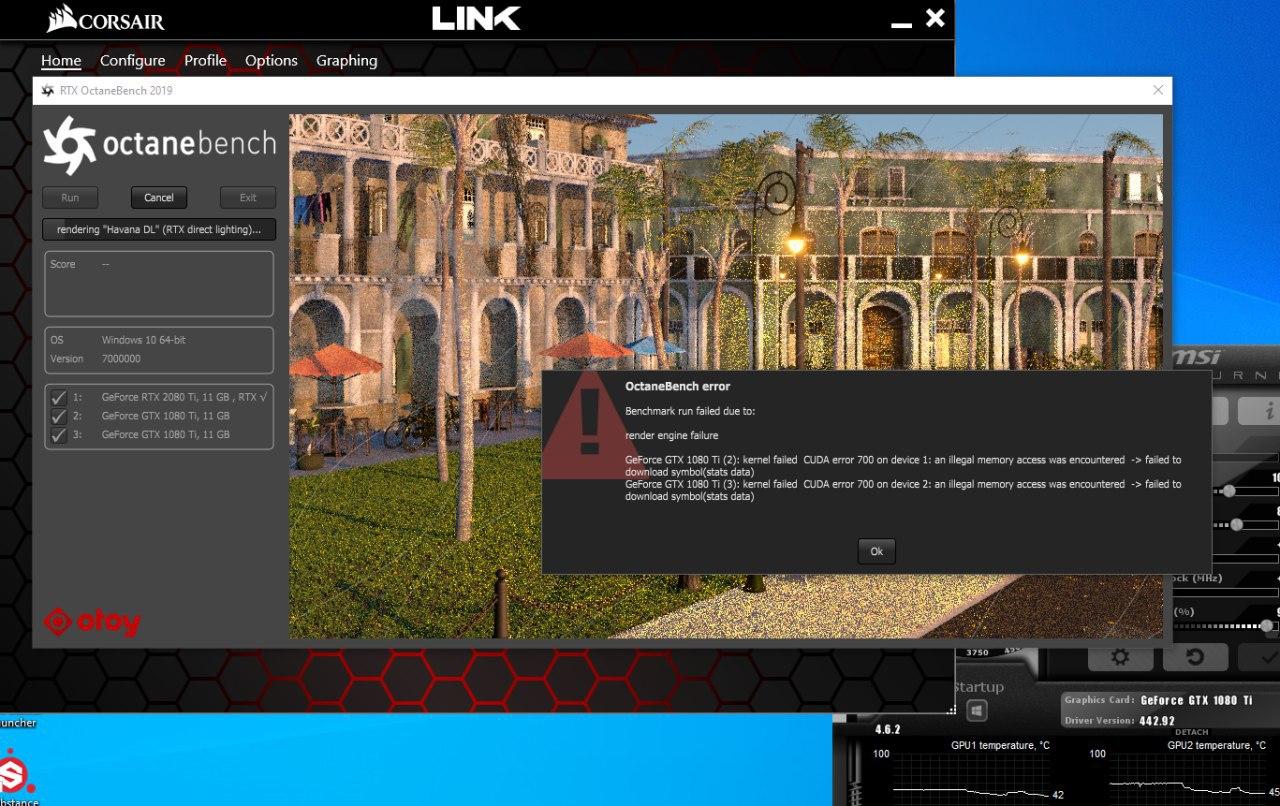

2080
2080
Benchmark crash
Benchmark crash
This is the GPU that crashed the benchmark. Since yesterday I've added 2 more 1080ti in the rig because I needed to render overnight, and it hasn't crashed this time. Unreliable.
