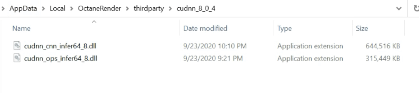

IM still getting this error after downloading the dlls to the correct folder and re-installing Octane. Why has it always been so hard to install Octane? Since the beginning of time. If I hit the download button in the interface, it completes and then this pops up, I hit OK and then it says "Octane3dsmax.dlr failed to initialize". I have to remove the dll or I cant load Max at all. This just seems like a terrible implementation.

Hi DustinM,
try to manually download the cuDNN library following this link:
https://render.otoy.com/downloads/ef/08 ... _4_win.zip
Then place it in C:\Users<user name>\AppData\Local\OctaneRender\thirdparty\cudnn_8_0_4\" folder so all octane builds (standalone and plugins) can load it.
Regards
